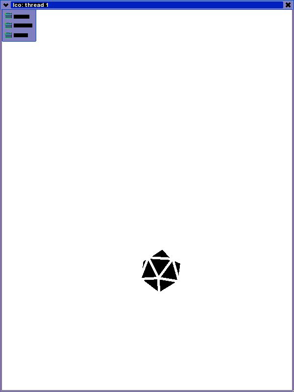

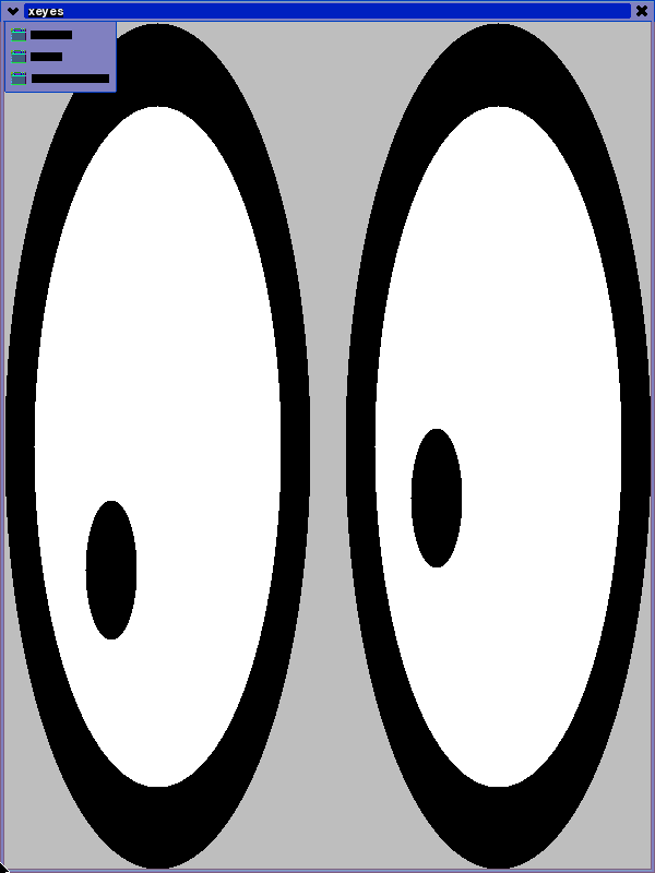

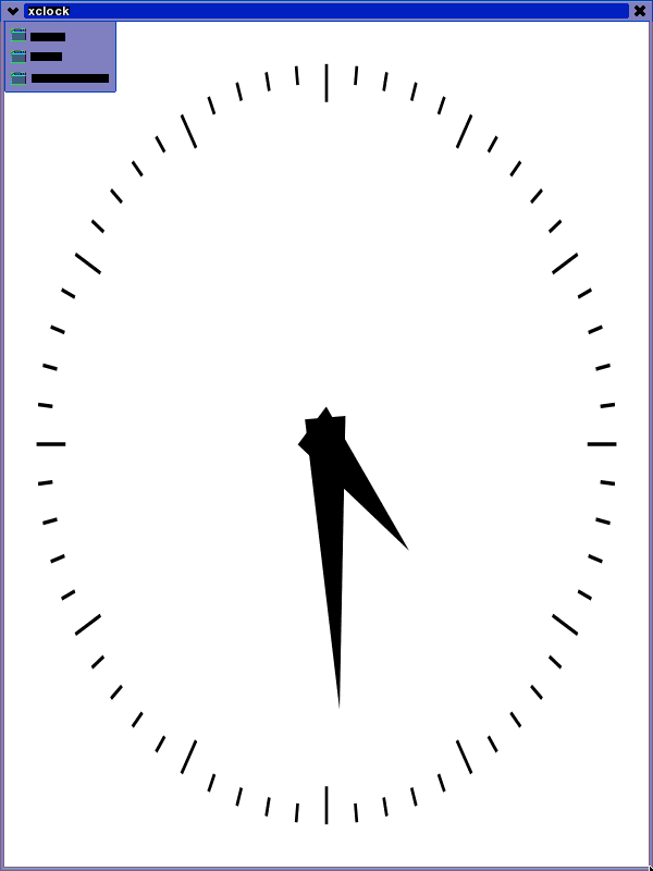

So a little bit more love and we have matchbox-window-manager running on the 3
Happy with that.
Name:	TightVNC: kindle:0.0_314.png
ID:	95330   Click image for larger version
Name:	TightVNC: kindle:0.0_315.png
ID:	95331   Click image for larger version
Name:	TightVNC: kindle:0.0_316.png
ID:	95332   Click image for larger version
Name:	TightVNC: kindle:0.0_317.png

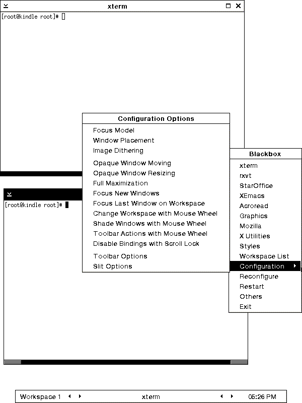

completed the mono theme for blackbox. no more visual artifacts created through dither.
Into the bargain the eink runs a bit faster
Name:	TightVNC: kindle:0.0_319.png
Old 11-02-2012, 06:30 PM   #72
geekmaster
Carpe diem, c'est la vie.
geekmaster's Avatar
Posts: 6,433
Karma: 10773670
Location: Multiverse 6627A
Device: K1 to PW3
That is a great accomplishment! Apps that use "old-fashioned" bitmapped fonts that are hand-tuned for a monochrome bi-level screen would look a lot nicer, if such things can still be found...
