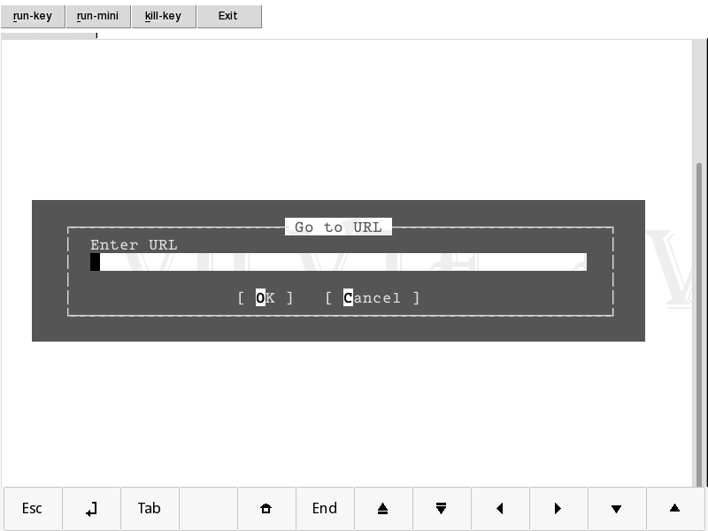

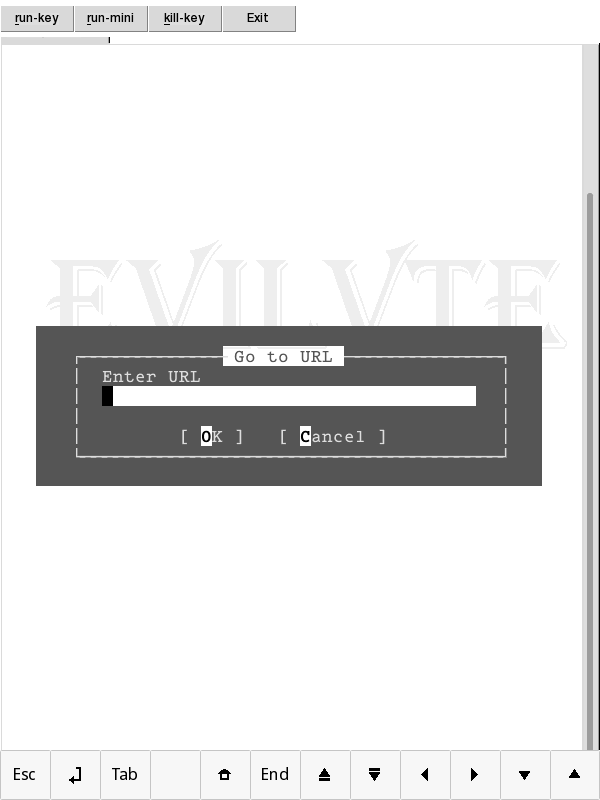

Mini keyboard in landscape mode. Replace the file keyboard-mini in the "layouts".
ID:	94803   Click image for larger version

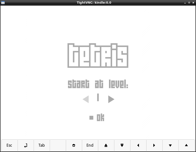

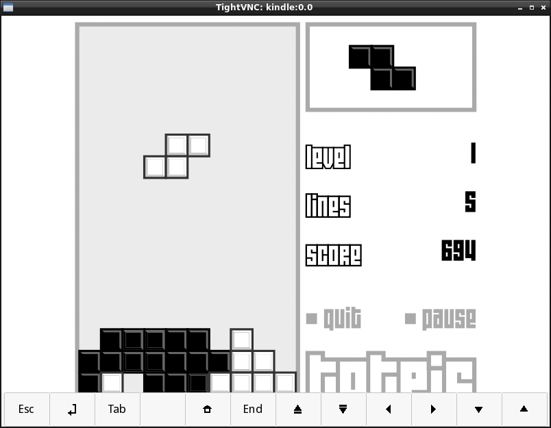

I have simply created another loader script that enables me select the orientation and conditionally return the relevant rotation. small detail but thought I would say it.
Thanks very much indeed for your work on this. Greatly appreciated.
Name:	TightVNC: kindle:0.0_291.png
ID:	94818   Click image for larger version
Name:	TightVNC: kindle:0.0_293.png
