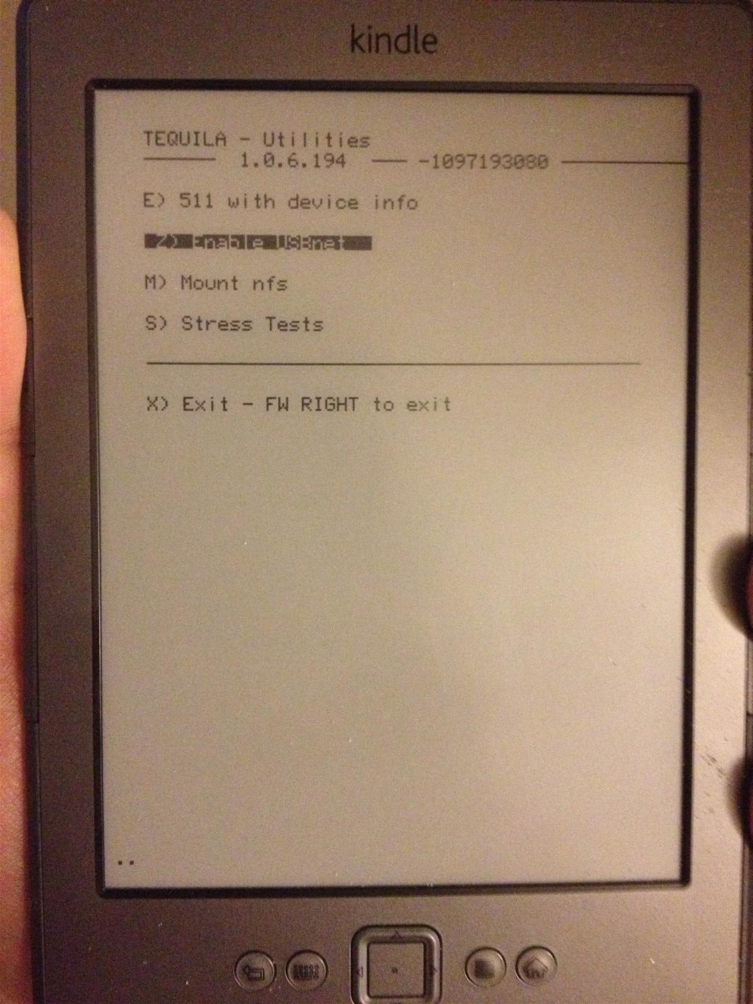

In the attached image you can see the problem. I have tried leaving the battery lead off, but alas, to no avail. It is stuck on this screen and nothing works at all.
I suspect it is now just spare parts
A.

For some releases of the diag. firmware, the "Exit" function only works over the serial console port.
(That diag. menu is also being written to the serial console port.)

Ok so is it worth re-trying plugging it in? Perhaps it's in a loop or something?

Ah,
Did you try the menu entry that is shown highlighted?
If you did, then did it show up as USB storage when you plugged it into your PC?
If it did, was their an "ENABLE_DIAGS" file in the root of USB storage?
If there was, did you try to delete it, eject the storage, unplug the cable and re-boot the Kindle? (verrrry loooong press on power button).

Hi.
Press THE RIGHT HAND ARROW bit. (of the 4 way at the bottom)
See? It's saying that at the bottom... FW RIGHT to exit (Four Way Right to exit)
only that key press will exit the Diags.

Hi
That doesn't work. It's stuck on that screen
Any other ideas?
A.

Hmmmm "Doesn't work" in the sense that when you pressed it the screen didn't change?
This thread is titled "Kindle 4 NT: No SSH" - so do you have SSH access or not...
Because if you DO then that might not be a bad idea.
Are you saying the device is "Stuck" in debug mode.
At this point I think it more likely the screen is actually broken.
What happens when you Hold down the power for 20 seconds.
Does the screen flash? Do the lights change?
If the lights change and the screen does nothing I would guess that the screen(/screen controller) is actually toast.
EDIT: However I currently have a few kindle 3's that also fail to update the screen and I know those screens work.
Serial cable time.
