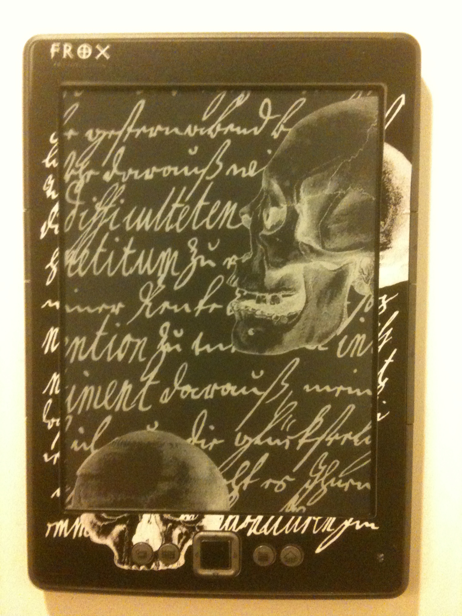

Ceuse knows what time it isCeuse knows what time it isCeuse knows what time it isCeuse knows what time it isCeuse knows what time it isCeuse knows what time it isCeuse knows what time it isCeuse knows what time it isCeuse knows what time it isCeuse knows what time it isCeuse knows what time it is
Posts: 24
Karma: 2016
Join Date: Oct 2011
Device: Kindle 4 Non Touch & Kindle Keyboard
yep thanks alot. totaly worth the trouble even though i couldt get the 100% fitting pic
