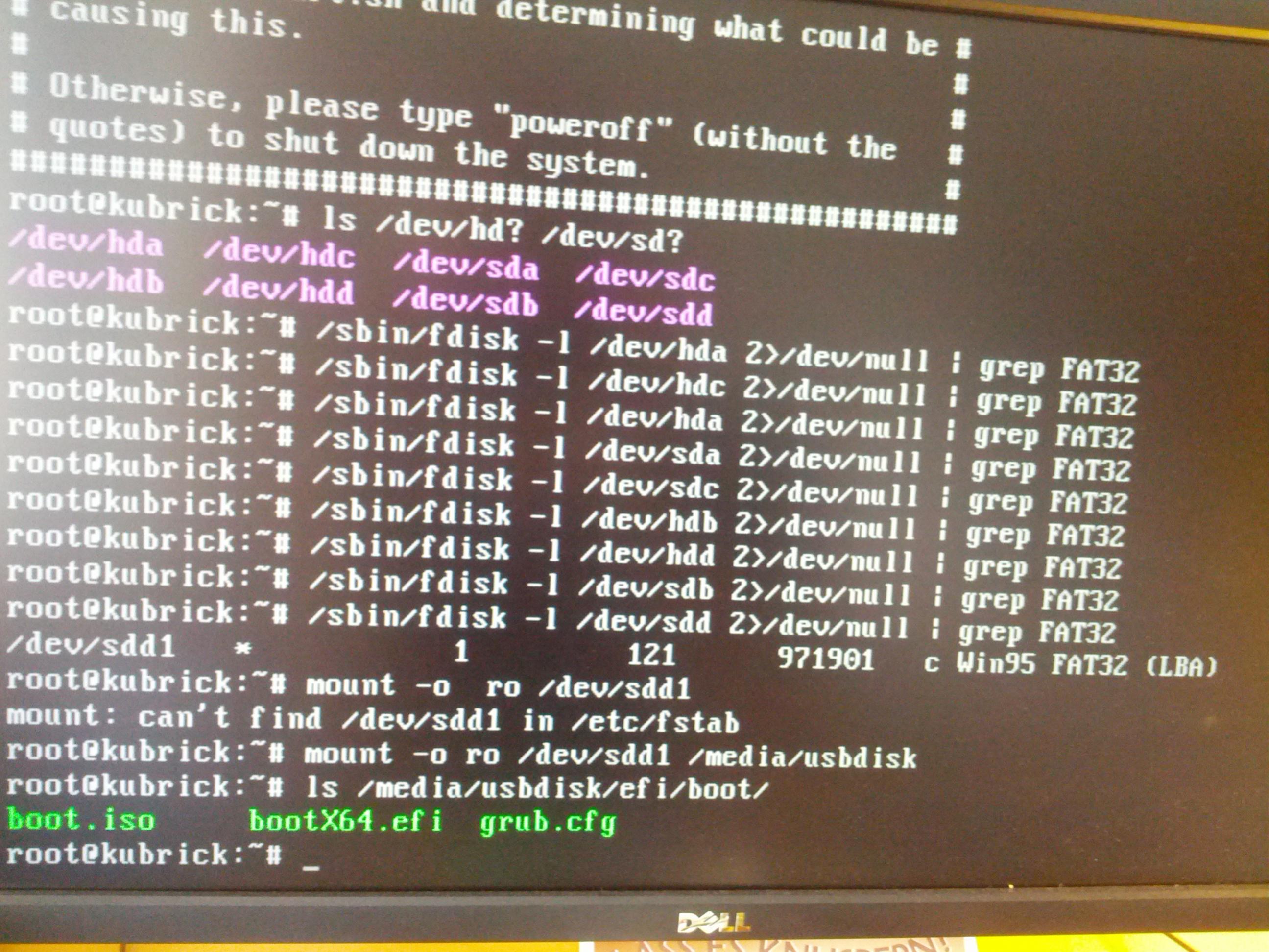

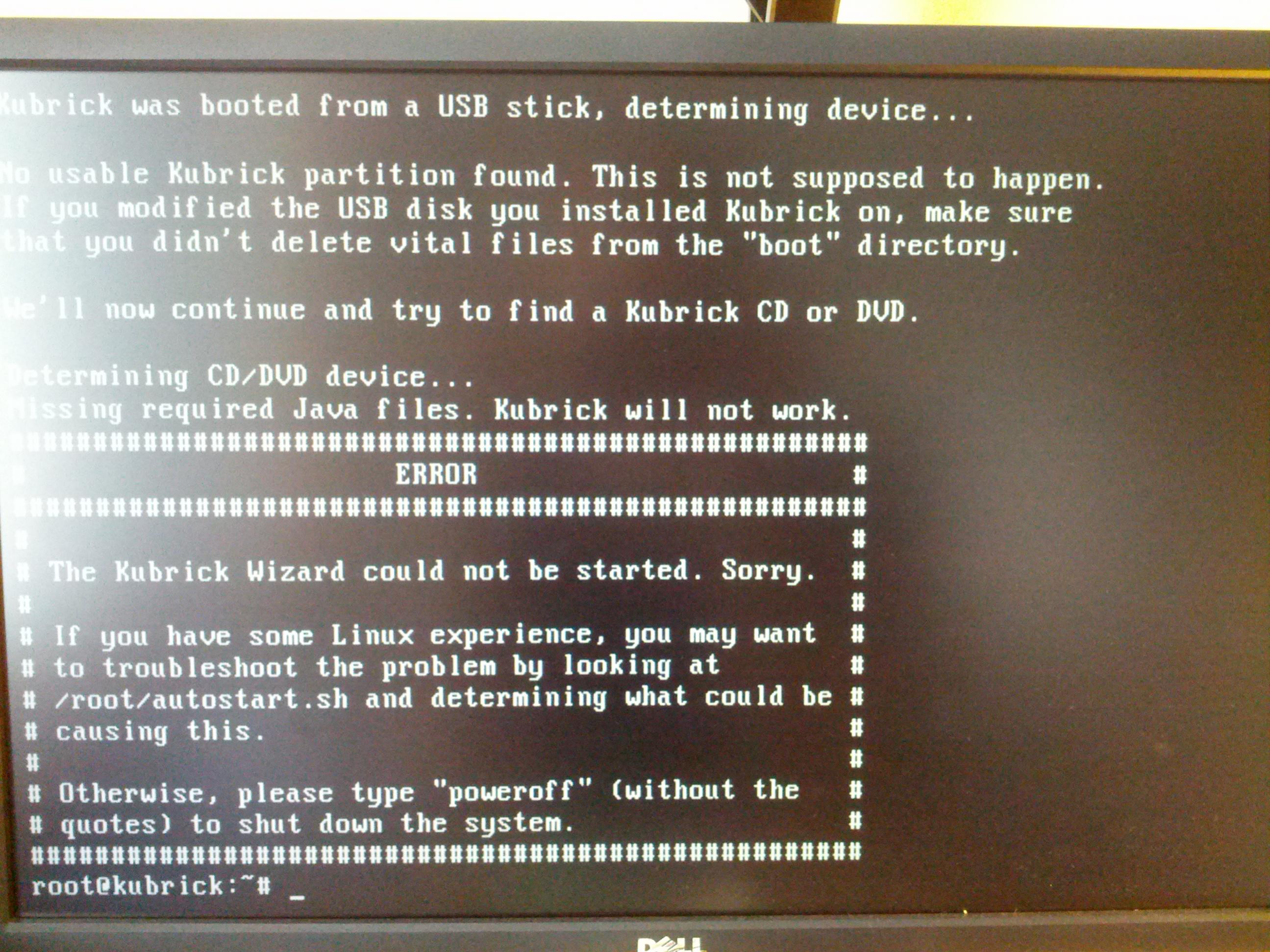

hi. i have a K4 with a "your kindle needs repair" screen and wanted to try kubrick, but it's not booting.
what i did: downloaded the usb base zip, and flashed the image with the win32 flasher. then i downloaded the K4 iso and copied it to the efi/boot folder. when i boot from the usb stick, i'm getting "no usable kubrick partition found" (first attached image).
so i tried to debug it a bit and did the steps in the script manually (second attached image), but from doing that i can't identify the problem. does anyone have an idea?

hey guys, could someone help me with my problem described in post #725? (quoted here)
edit: i did the steps in https://bitbucket.org/ixtab/kubrick/...t=master#cl-48
