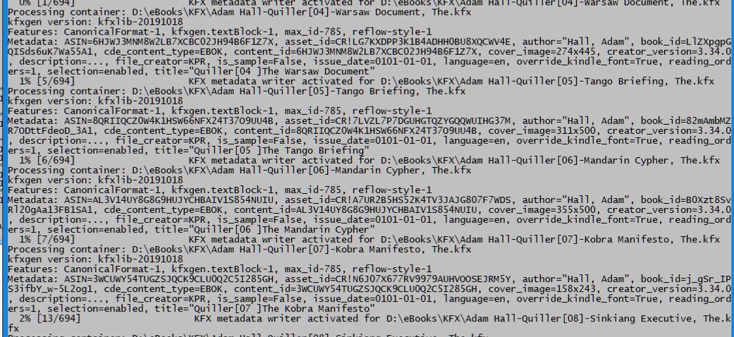

CalibreDB and KFX output PI seems to take a long time
I'm using calibredb to extract (copy?) the KFX books to a new single folder:
export --progress --all --dont-save-cover --dont-write-opf --format kfx --single-dir --template "{authors}-{series}{series_index:0>2s|[|]-}{title}" --to-dir "D:\eBooks\KFX"
It seems like there's a lot more happening than just the copy and it seems like that if it's embedding the metadata, it takes a lot longer than for the same for an ePub.
Is that just a 'side effect' of the plugin or something else?

Updating metadata in KFX files is fairly slow. Add the --dont-update-metadata option to speed things up. From the manual:
Normally, calibre will update the metadata in the saved files from what is in the calibre library. Makes saving to disk slower. Specifying this switch will turn this behavior off.

Thanks, but unfortunately I think I do need the metadata updated
I was just wondering since it seems that the KFX part of the calibredb job takes longer than the epub part
