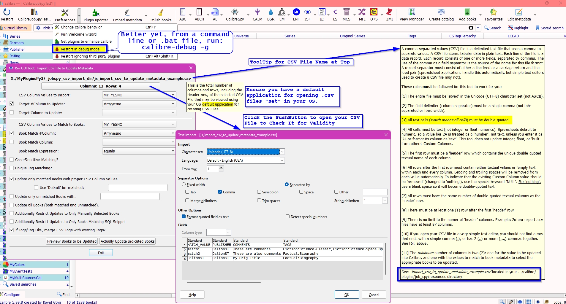

Thank you for taking the time to answer!
The date format mentioned in the custom column tooltip (Target #Column to Update) is 'datetime' datatype. I searched on google what 'datetime' refers too, but didn't find a definite answer so I assumed I could use the format mentioned in the tooptip below for standard column (Target Column to Update), which is YYYYMMDD of YYYY-MM-DD. When those two formats gave me the 'Unknown string format' error, I tried the other three formats I listed above, just in case.
Now, I realize that this must be something quite basic that I don't get, and that it's probably written on the print screen you attached, I just don't know the date format I should use.

See the attached image.
I suspect your .csv file has an issue somewhere in the 2nd column. Remember, all columns in your .csv file are "text" (including dates and numbers). Run in debug mode so that JS will tell you exactly what is going on, and what it thinks your .csv file looks like to it.
As a last resort, create a 3d column that you ignore, but helps to identify the 2nd date column as valid "text".
Running in debug mode for this tool is very helpful if you encounter any data problems in your .csv file.

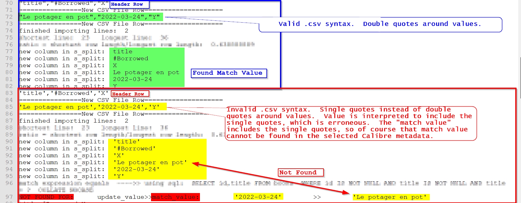

Double quotes are used in csv files to surround values
The log shows that your csv file uses double quotes for some rows, and other rows have single quotes. Double quotes are used in csv files to surround values. The single quotes will cause errors. Too bad you did not attach your csv file so I could examine it.
See the attached annotated image of a part of the log file that you posted.
What application are you using to create your csv file, Calc or Excel? I hope not a simple text editor, as that would cause the inconsistent results shown in the log.
Added: This csv file format error will be self-repaired by the Tool starting in the JS version for Calibre Qt6, 5.99.8+.

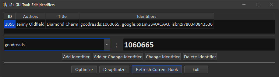

Qt6 error: Edit Identifiers throws an error.
calibre, version 6.0.0
ERROR: Unhandled exception: <b>AttributeError</b>:type object 'QDialogButtonBox' has no attribute 'AcceptRole0'
calibre 6.0*  embedded-python: True
Windows-10-10.0.19043 Windows ('64bit', 'WindowsPE')
('Windows', '10', '10.0.19043')
Python 3.10.1
Windows: ('10', '10.0.19043', '', 'Multiprocessor Free')
Interface language: None
Successfully initialized third party plugins: DeACSM (0, 0, 15) && DeDRM (10, 0, 2) && Action Chains (1, 17, 2) && Barnes & Noble (1, 2, 16) && Comments Cleaner (1, 6, 3) && Count Pages (1, 11, 2) && Embed Comic Metadata (1, 6, 1) && EpubCheck (0, 2, 4) && EpubMerge (2, 13, 0) && EpubSplit (3, 3, 0) && Extract ISBN (1, 5, 1) && FanFicFare (4, 14, 0) && Fantastic Fiction (1, 5, 1) && Favourites Menu (1, 1, 0) && Find Duplicates (1, 9, 5) && Generate Cover (2, 1, 0) && GetFileName (0, 2, 0) && Goodreads (1, 5, 3) && Import List (1, 8, 3) && Job Spy (1, 0, 191) && Kindle hi-res covers (0, 5, 0) && KindleUnpack - The Plugin (0, 83, 1) && Kobo Books (1, 9, 2) && Kobo Utilities (2, 16, 3) && KoboTouchExtended (3, 6, 0) && Last Modified (0, 8, 2) && Manage Series (1, 3, 0) && Modify ePub (1, 7, 3) && MultiColumnSearch (1, 0, 89) && Obok DeDRM (7, 2, 1) && Open With (1, 7, 1) && Overdrive Link (2, 51, 0) && Quality Check (1, 12, 0) && Reading List (1, 12, 0) && Search The Internet (1, 8, 1) && SmartEject (2, 5, 0) && Standard Ebooks (1, 0, 0) && Sum Column (0, 3, 1) && View Manager (1, 8, 0) && Walk Search History (1, 3, 2) && Overdrive Link Metadata Source (2, 51, 0)
  File "calibre_plugins.job_spy.ui", line 10701, in show_edit_identifiers_dialog
  File "calibre_plugins.job_spy.identifiers_edit_dialog", line 202, in __init__
AttributeError: type object 'QDialogButtonBox' has no attribute 'AcceptRole0'

Quick question: Is the text meant to be this large? I seem to recall it being smaller before.
Name:	2022-07-13 16_51_01-JS+ GUI Tool_  Edit Identifiers.png
