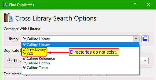

My question is similar to the one asked by mariekes on 04-18-2020, 08:47 PM.
Where is the list of previously searched libraries stored?
The directories shown in the drop down list have no connection with calibre's 'master' library list and appear to be stored in a separate file used by this plug in.
The image below shows a list of 6 directories which include 2 non-existent (phantom) directories.
I have tried uninstalling the plugin, restarting calibre and reinstalling the plugin, but the phantoms directories are still there.
TIA
Dave

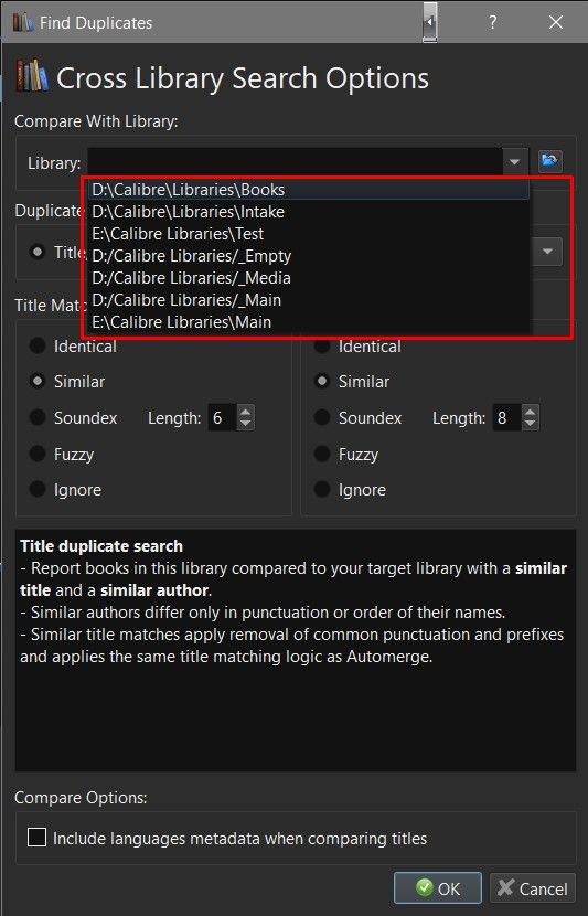

@davidfor - re the problem reported by mariekes and bmcs. I am seeing this in the select library drop down:
Name:	Annotation 2020-06-09 082023.jpg
I would expect to see something like this list from gui.json
  "library_usage_stats": {
    "D:/Calibre/Libraries/Books": 213,
    "D:/Calibre/Libraries/Default": 8,
    "D:/Calibre/Libraries/Empty": 5,
    "D:/Calibre/Libraries/Intake": 73,
    "D:/Calibre/Libraries/Journals": 305,
    "D:/Calibre/Libraries/Media": 1042,
    "D:/Calibre/Libraries/Test": 921
But it appears I'm seeing this list from history.plist
	<key>lineedit_history_find_duplicates_plugin:library_duplicate_combo</key>
	<array>
		<string>D:\Calibre\Libraries\Books</string>
		<string>D:\Calibre\Libraries\Intake</string>
		<string>E:\Calibre Libraries\Test</string>
		<string>D:/Calibre Libraries/_Empty</string>
		<string>D:/Calibre Libraries/_Media</string>
		<string>D:/Calibre Libraries/_Main</string>
		<string>E:\Calibre Libraries\Main</string>
	</array>
Perhaps you could look into why this is happening? Maybe something changed in a recent release. I stopped using Find Duplicates->Library Duplicates feature when DaltonST released CalibreSpy.
After closing calibre, I was able to remove the lineedit_history_find_duplicates_plugin:library_du plicate_combo block, and then use the browse button to locate one of my existing libraries with no side effects. That of course recreated the list in history.plist. I'm hesitant to suggest mariekes and bmcs do similar before you respond.

Thanks for the pointer BetterRed. A simple edit of the erroneous path strings in history.plist solves the issue.
