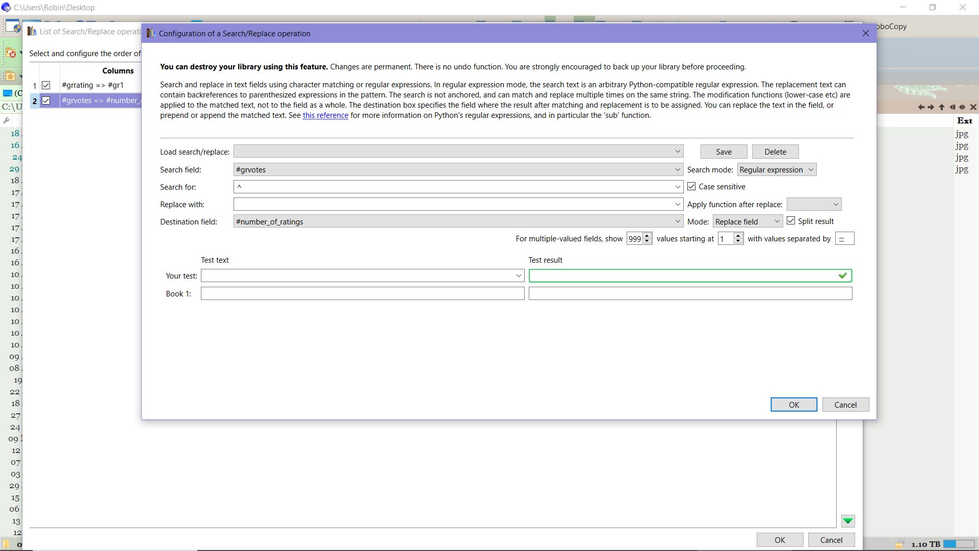

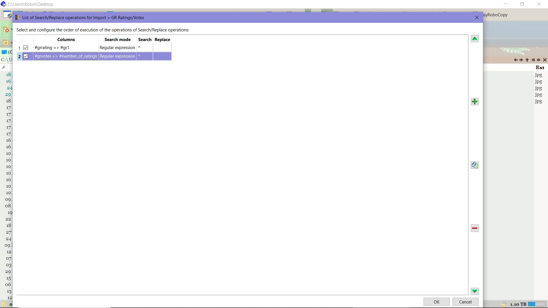

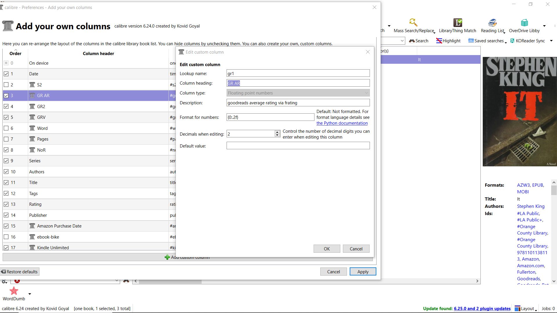

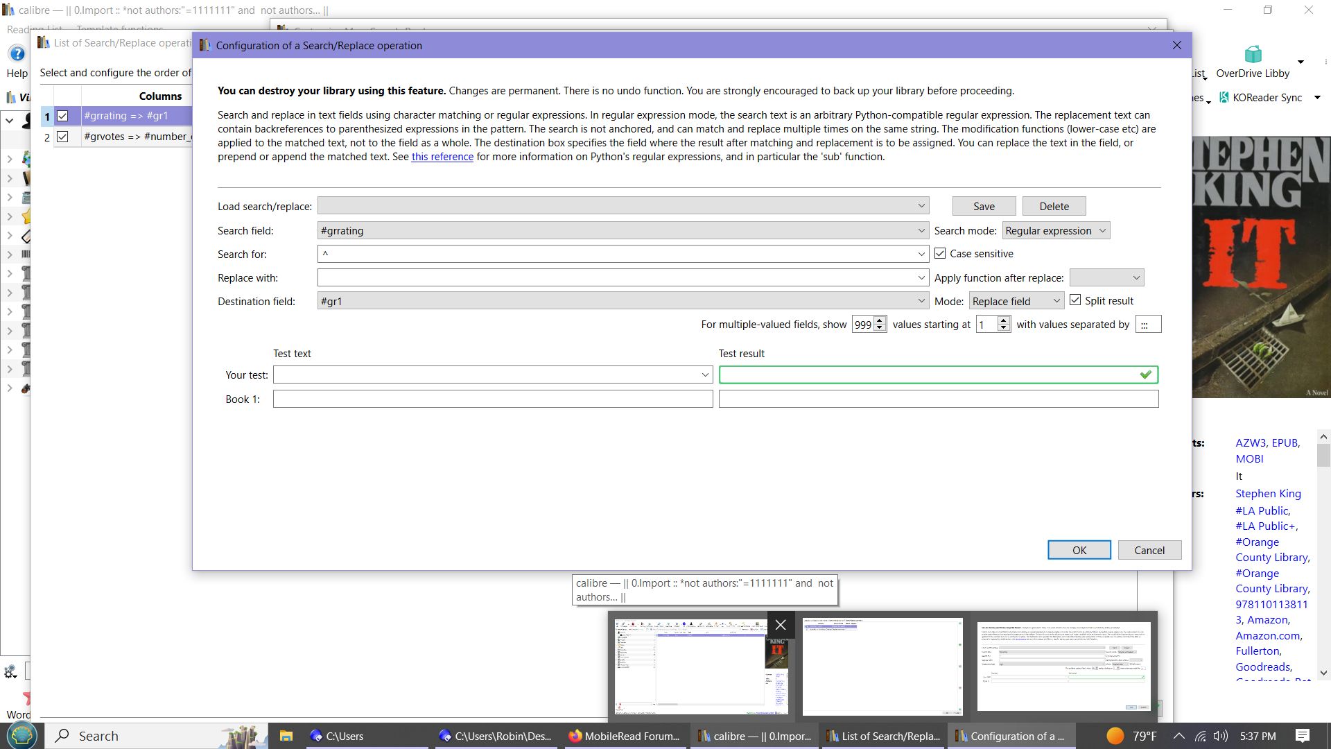

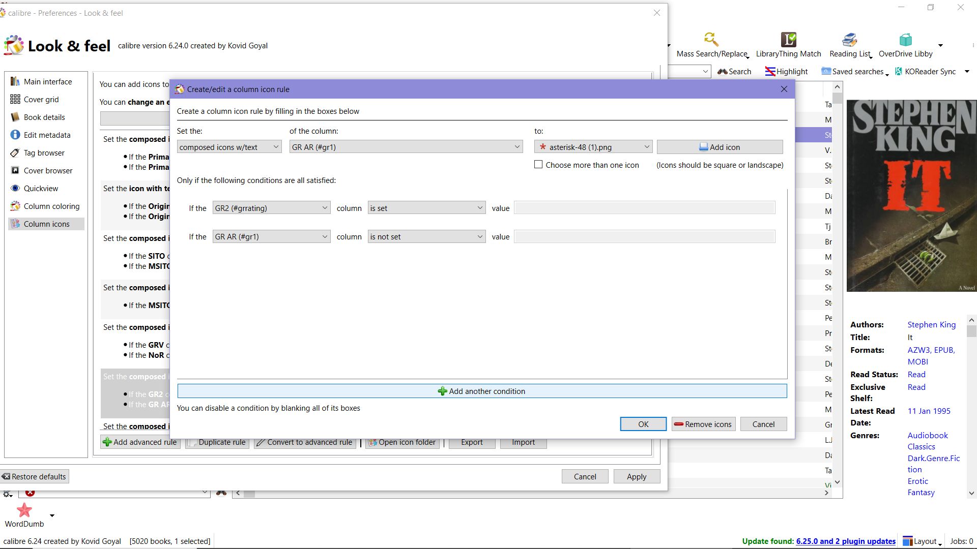

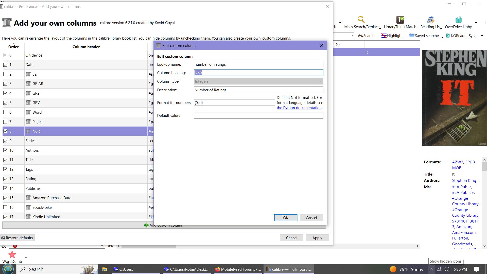

Originally Posted by nguoi doc sach View Post
Please someone help me,
I want to put a comma in Votes numbers but I don't know how to do it correctly. Does anyone figure out this yet?
Hi!,
Here is what I do. Sorry it's long, but once it's set up you are good.
I have always used the Goodreads Rating plugin with F_rating, but lately I have just used the new Goodreads with the ratings and the number of votes. Since these are recorded as identifiers, you need to create the custom columns for the identifiers, but this is where you can modify it.
I attached some pictures to show:
Create the columns needed by the new plugin for the average rating and the number of votes as directed.
If you haven't already, create a floating intenger column for the average ratings (for me it's the same column that was created with the older plugin {#gr1})
Also create a new "number of votes" column
If you haven't already done it, it's a good time to install the "Mass Search and Replace" plugin. Create a new rule for GR Ratings/Votes
Create two sets of rules where you copy the column with the identifier for ratings to the column you created with the floating decimal point.
Do the same thing for the number of votes
Now you need to create an icon rule of some sort to let you know when you have a ratings/votes in a book that isn’t showing up in the new columns you set up.
These columns are set up so they automatically follow the decimal point and commas you want. Since you can’t do it with identifiers, and because the column for the identifiers is composite and you can’t change it, what you want is to move those identifiers into the column you created.
Now you should have the "Mass Search and Replace" plugin installed. If you do, then create a new set of rules for moving the numbers from the composite columns (the ones filled in by the plugin) to the new ones. Two rules, one for each column. Give it a name like “GR Ratings/Votes” and basically only run it when you know you have the numbers.
I also created an icon rule set that lets me know when the plugin added new ratings/votes, but I haven’t yet copied them over. This is nice to let you know when you need to do it
Kind of a pain to set up, but once it’s done, it’s pretty autmated and will get those ratings/votes into columns with decimal points and commas.

Old 08-21-2023, 12:02 AM   #707
dunhill
dunhill's Avatar
Posts: 1,215
Karma: 1513034
Join Date: Sep 2017
Device: moon+ reader, kindle paperwhite, Linux Mint
Very well explained by Rellwood the option with comma
But it is more automatic as explained in https://github.com/kiwidude68/calibe...custom-columns
As intended by kiwidude the plugin collects the data and puts it first in the identifiers field and then in each custom column.
And the truth is that in goodreads the rating number is with a point.
But everyone can choose how to do it and here is the other option.
