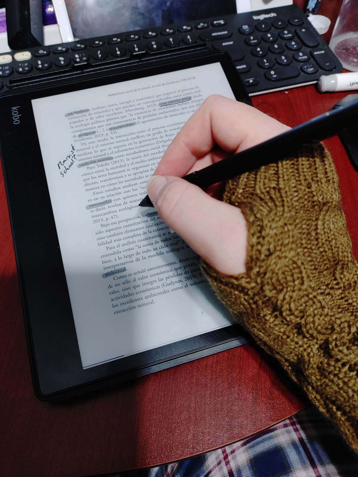

Originally Posted by Cootey View Post
I’ve noticed that the best way to annotate ebooks is to select “swipe only” for navigation. The default setting (tap & swipe) gets in the way of annotation because the pages keep turning on me while I am annotating. My wresting hand is often interpreted as a tap, especially when annotating near the edges. It’s possible to write on one page then suddenly be writing on the next or previous.
Now I only run into problems when I am annotating something in the middle of the page. My wrist can accidentally activate the menu. It’s not usually a problem unless I am jotting notes at the top or bottom of the page.
Anybody else notice this?
Obviously, the best solution is to learn to annotate with your wrist suspended in the air with the stylus tip being the only point of contact, but this leads to poor handwriting.
Sent from my iPhone using Tapatalk Pro
This is my solution for palm rejection glitches. I find that no matter the device, part of the issue is proximity of the stylus to the screen in order to activate palm rejection (which the Elipsa does have, you just have to be closer with some devices) . Many don't activate until you're close, which means if you lift the stylus too much while pausing, thinking (or just point the tip away while doing so) then the rejection deactivates. Other devices are more sensitive and let you pull your hand farther away, but then this gets annoying if you want to use the same hand you use to write to navigate. You have to manoeuvre the tip away and keep it away while navigating with one of your fingers. I also think the bigger your hand the worse the issue since a bigger hand will hold the pen in resting position farther from the screen.
I've had issues with Apple, Samsung, Lenovo, HP HTC, etc. Using both Wacom AES and EMR (and whatever Apple uses). So while they might finetune the software or whatever I doubt ti will ever be perfect for me and others (for some definitely, but it's one of those can't please everybody all the time things).
Even so, I also turned on the swipe only for navigation.
