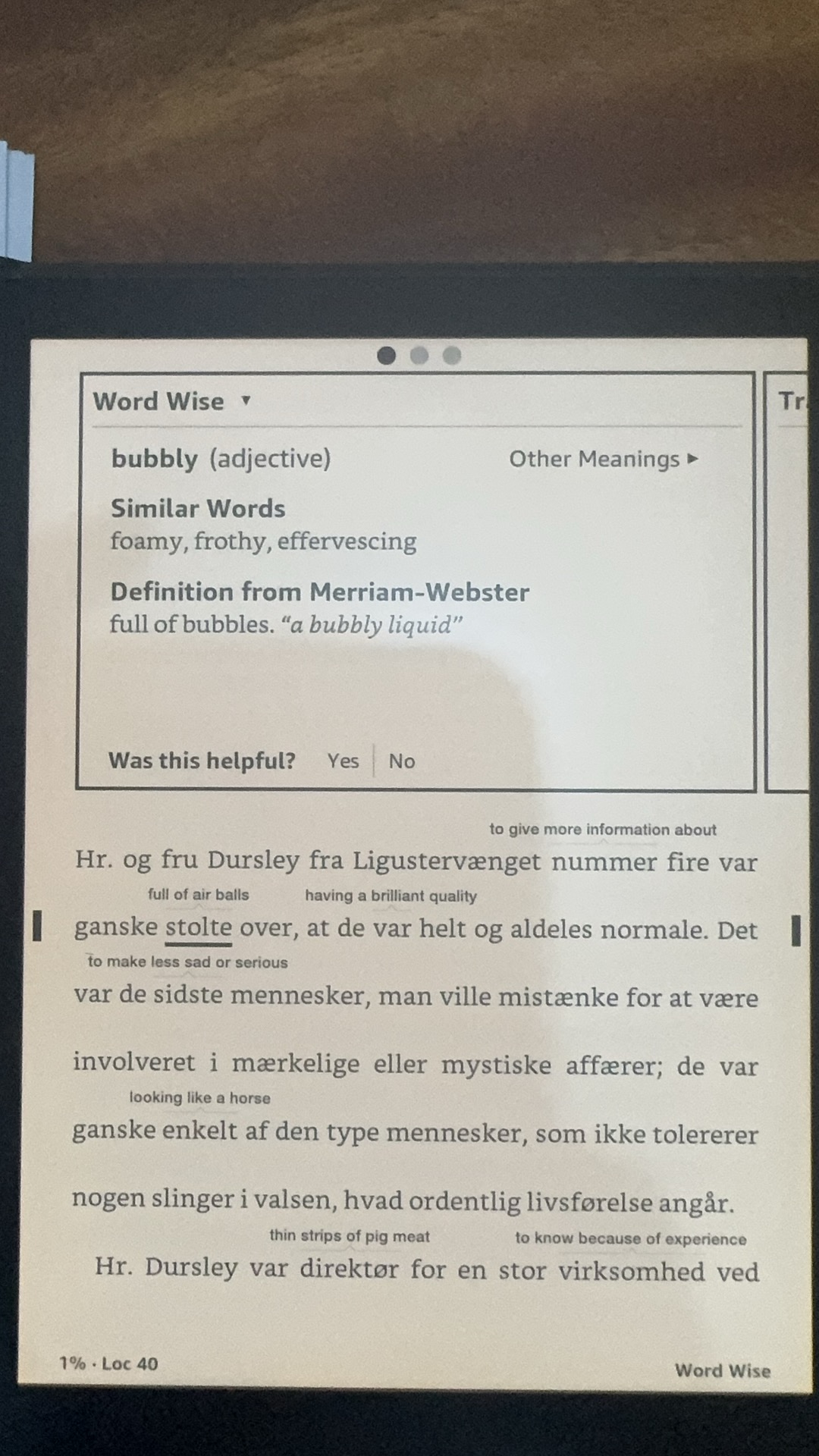

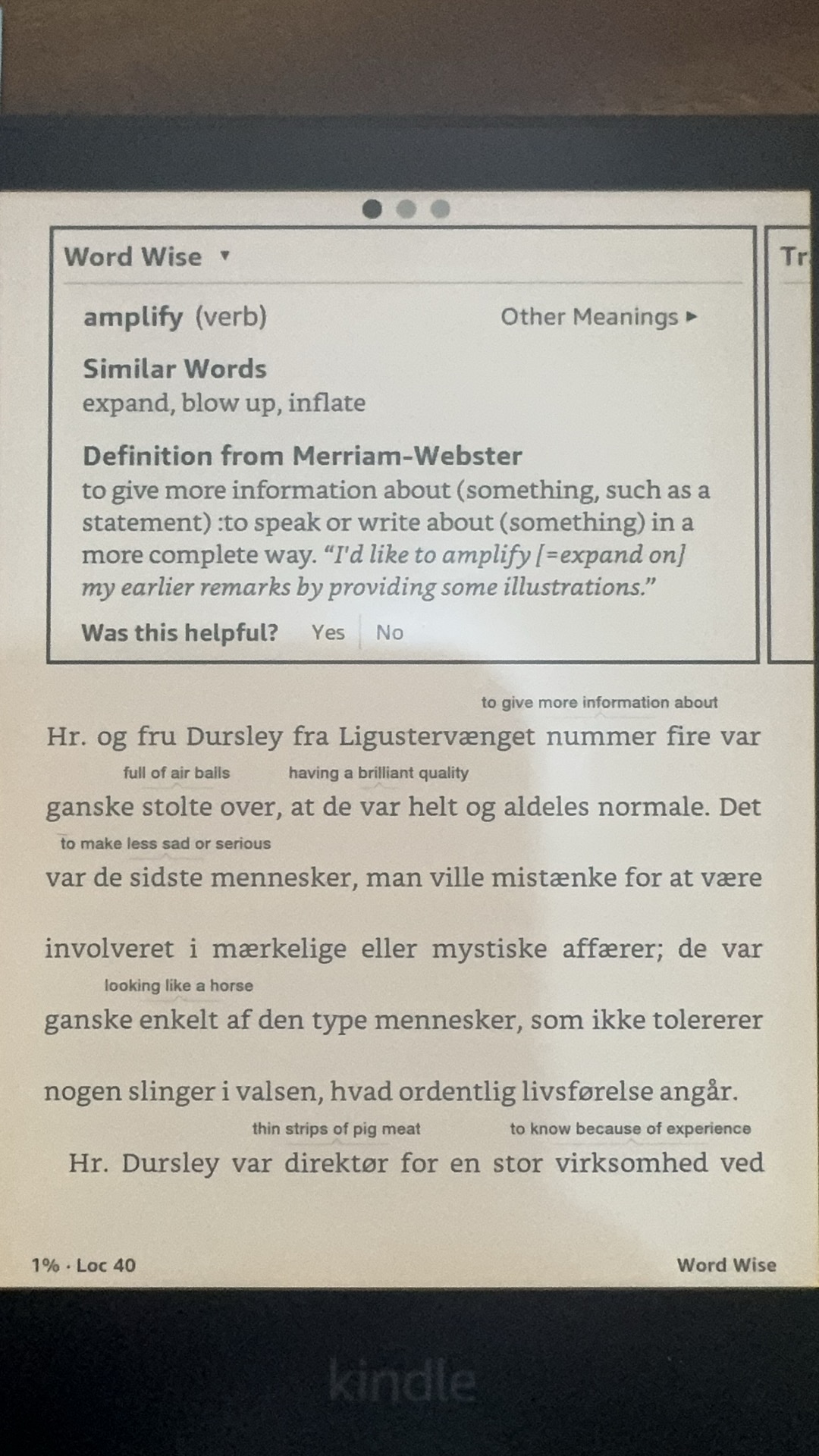

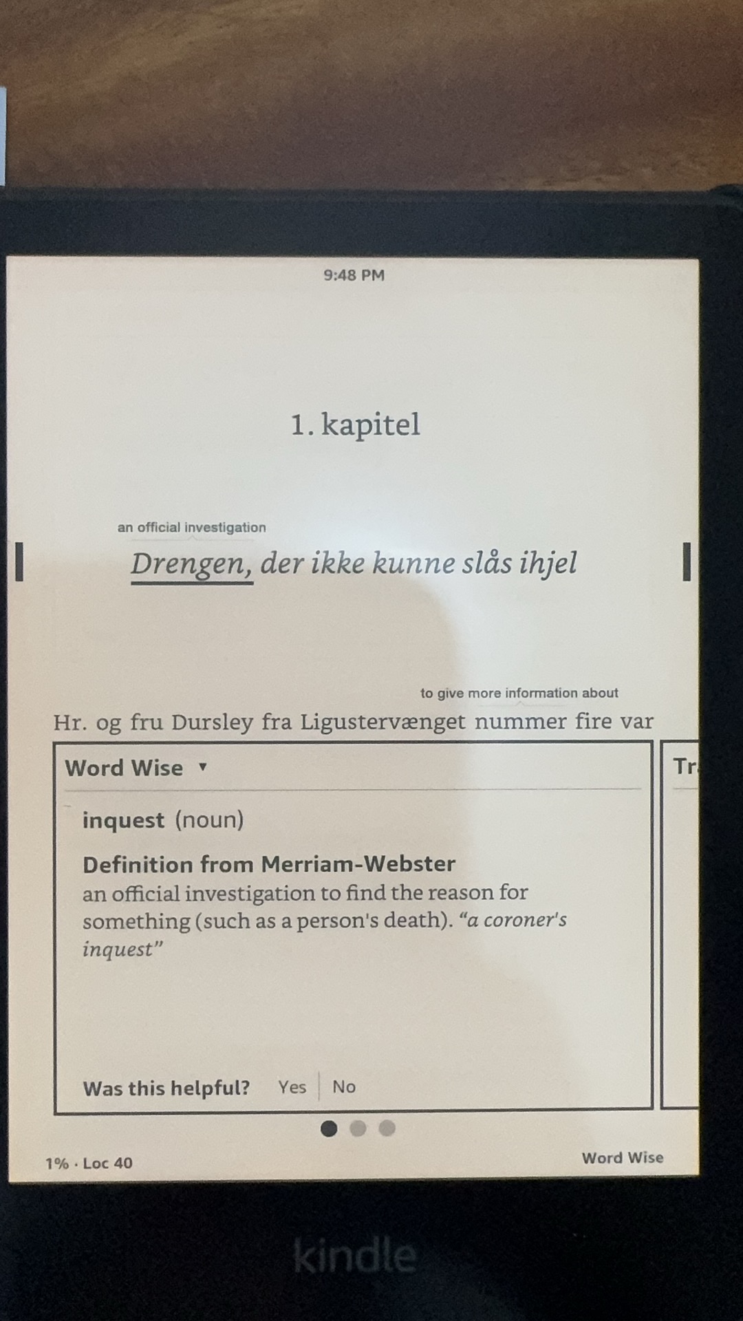

Smile Questions for danish to english wordwise
I just mada an issue in github and you replied almost immediately, thank you very much! It did not solve my problem but from you reply I think it's not a bug so I change to continue my question here.
As you can see from the pictures in the attachments, all the danish words are not recognized correctly
The danish word drengen (the boy) is recognized to inquest,
The danish word stolte (proud) is recognized to bubbly,
The danish word nummber (number) is recognized to amplify,
All the words are wrong like this.
I did the following steps to add wordwise to the book:
1. book is local in calibre in azw3 format
2. Clicked Customize Kindle Word Wise in Customize WordDumb Preference
3. Set Book Language to Danish and clicked OK
4. Clicked Save in the popped out vocabulay list
5. Clicked OK in the Worddumb Preference
6. Clicked the star icon with kindle connected
7. Waited for jobs to finish
8. Unpluged kindle from computer and checked the book, word wise is not correct
9. Tried to change word wise language to Chinese and nothing changed but the word wise language was acutually changed to Chinese and were still wrong.
Thank you for you kind help! I'm learning danish and this function is super helpful!

You have to change the word wise language to Chinese in your Kindle's settings
If Kindle's default Chinese word wise database on Kindle is not replaced by Wiktionary database, connect kindle to calibre run the plugin again.
