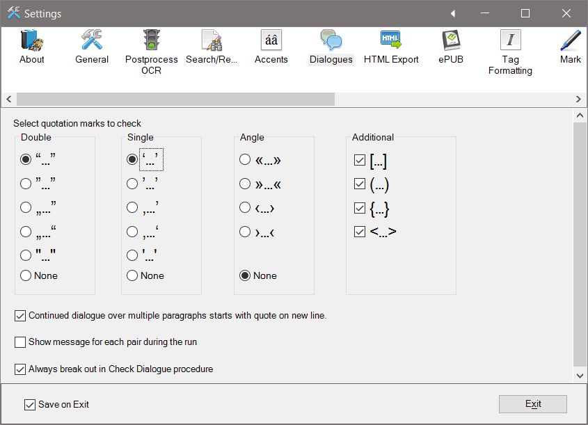

What happens if you click somewhere in the text outside the error zone - e.g. just before the unmatched starting quote. Don't type anything, just move the insertion point.
That's what I have to do for the multi-paragraph quotes in English.
FWIW these are my Check Dialogue settings

As I use to work with doubel angle quotes, my settings are different in this respect, but the same concerning the rest (except the "Continued dialogue" box.

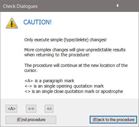

I have Always break out in Check Dialogue procedure checked, when CD finds an error it shows this non-modal window:
Name:	CD Breakout.jpg
That window has its Stay-on-top attribute set, which makes it hard to hide. After dealing with the error I click the Back to the Procedure button
@Leonatus - are you getting that popup?
And did you try adding a '»' at the end of the quotation, if it 'fixes' your problem we will know for sure it is related to that specific text.
