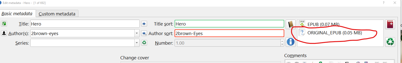

Just in case anyone else is or does have this issue.....I spoke too soon because I was still having this issue with FF.net, so I went into Preferences and under Adding Books unchecked Automatically Convert Books to the Preferred Output Format under adding Actions and under Automatic Adding. It seems to have fixed the issue as I just tried with updating a story from FF.net.

So, some additional info that I have learned about this to share with anyone also having this issue. I have also found that I have to delete the Original_EPUB file in the metadata before updating or I get the same issue. As soon as I delete that the update works like a charm. I am not sure how to stop Calibre from creating this. As soon as I delete it, then do my update (works no problem all chapters are there), then check the metadata again the file is back and I will have to delete it again before the next update. Totally weird.
I have attached a screen shot with the extra file circled.
EDIT: Just figured it out! So when I had to rebuild my library, there was an extra file in each file location labeled Original EPUB. I went in to the file location and deleted them all. Looks to have fixed the issue.
