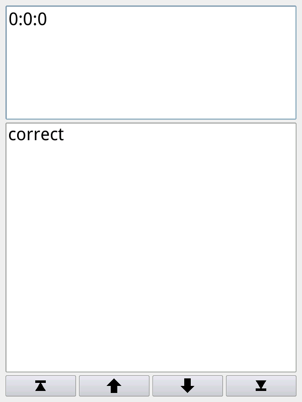

Let us try another thing. Install the test patch as you did with the other one.
When the test patch is installed and you power on the device (and it is the KSM turn), you will see a screen with the only menu entry "skip." Just wait some seconds until it disappears. This screen is for me. I am running the same installation as you on my device, and I do not want do have to run the test each time I power the device on.
Next you will be presented with several screens one after the other that look similar to the one you can see on the image below. If one of them shows the screen in the correct orientation, remember the numbers that are displayed in the information field (for instance 0:0:0 on the image), and press "correct." If we are lucky, the main menu will now be displayed with the correct orientation.

2:2:2 had the correct orientation

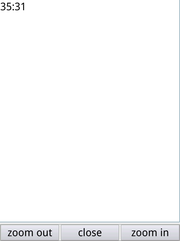

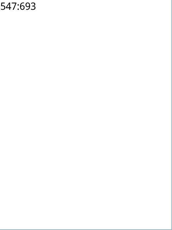

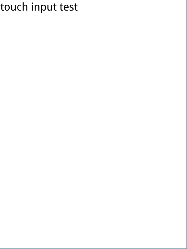

I upload a test package, and hope that this will help finding the cause.
Install it like you did with the others packages.
When booting into KSM the test will start:
  • you will see the message "touch input test" (screen_01.png)
  • touch the screen, if we are lucky there will be displayed the touch coordinates (for instance, screen_02.png [I touched somewhere close to the top left corner] and screen_03.png [I touched somewhere close to the bottom right corner])
  • touch the screen several times at different positions, do it systematically so that we later can understand how the actual touch positions compare to the registered positions (if there is anything registered at all)
  • the test will terminate after 30 seconds or so
  • 20 seconds later nickel will be started
This test runs only once to prevent further inconvenience. If you want to run it again, delete the file .adds/kbmenu_user/_skiptouchinputtest.txt
The test will create log files (touchinputtest_*.txt).

Here is what happened:
- on the first reboot after the install, I got the old display orientation test
- after power cycling I got the touch input test. However, there was no response to any touches. After 30 seconds the KSM appeared, this time in the correct orientation and with a better size font
- after that times out and Nickel started, the screen was still not responding to touch; I had to power cycle again
