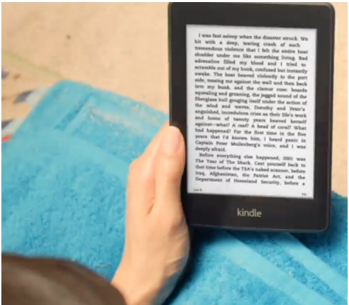

Originally Posted by eureka View Post
(Speaking cynically, with all these implemented but disabled features Kindle Touch is looked like hardware platform for beta-testing of Kindle Paperwhite firmware).
Well, let's hope so... Maybe that means it won't be that difficult to implement JB Patch for the PW.
I'm looking forward to the PW but *not* to going back to pre-JB Patch wonky 'justification' and lack of hyphenation (screenshot from PW commercial attached).
Name:	PW justification.jpg
