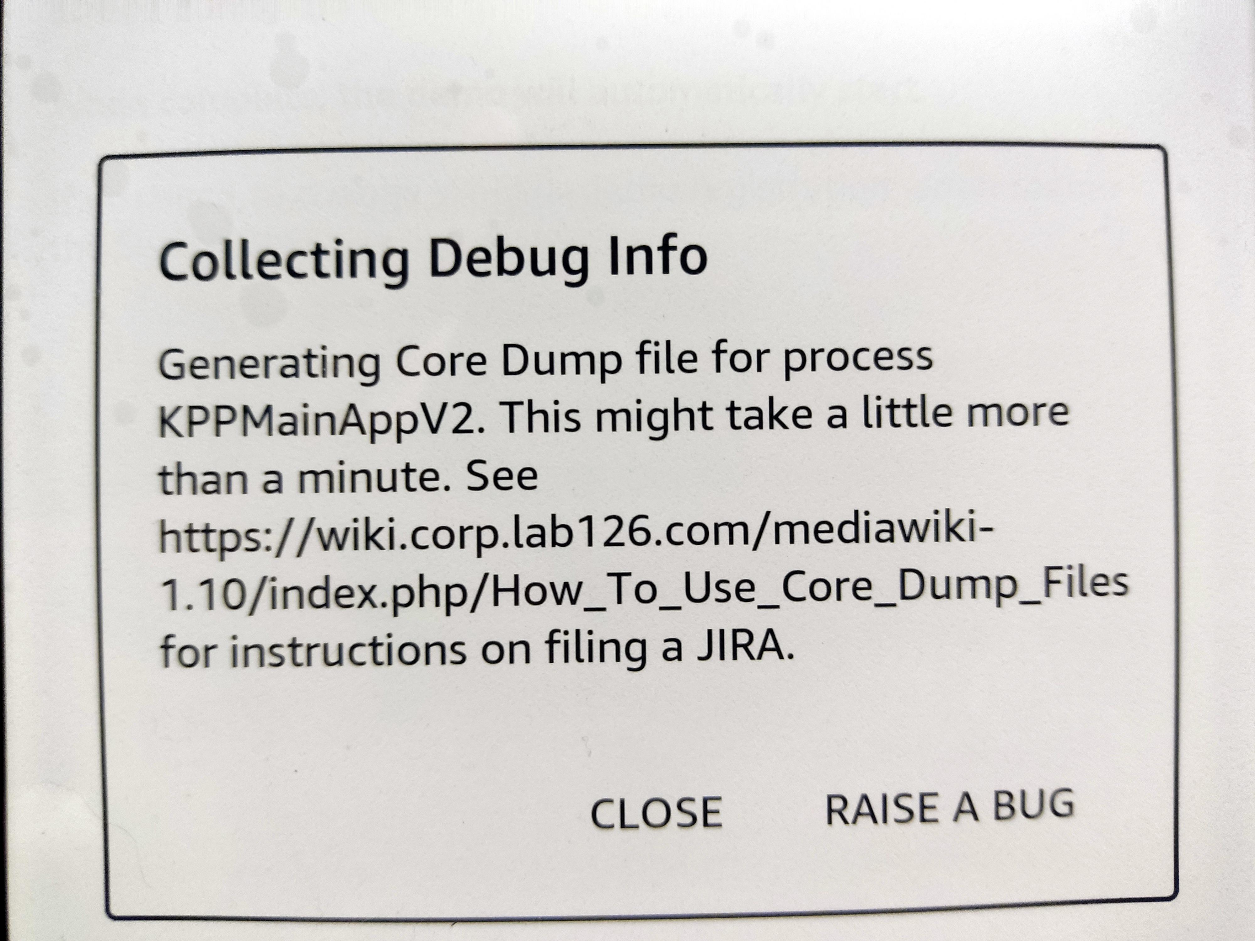

I'm in a similar situation, perhaps worse, to the one described in the previous post. I ran Languagebreak 1.0.2.1 on a Kindle with firmware 5.16.2.1.1, then successfully installed Kual, Koreader, and Renameotabin. However, I realized that I remained in managed mode and therefore could not activate airplane mode. I tried to exit managed mode, but I couldn't. At that point I tried to reinstall Languagebreak starting from step 1, but it was no longer possible. I thought it would be better to reset the device to do a clean install, but even then I can no longer restore the Languagebreak.
In my case the critical steps are 7 and 16:
7. Once the demo is setup, do the "secret gesture" (double finger tap on bottom right of screen then swipe left)
In my case, a window opens first with a message with two buttons at the bottom (CLOSE and RAISE A BUG), which I attach:
Collecting Debug info
Generating Core Dump file for process KPPMainAppV2
https://wiki.corp.lab126.com/mediawi...ore_Dump_Files
for instructions on filing at JIRA
I found a message of the same type in this post and NiLuJe wrote:
"That's the side-effects of having to flag the device as a debug-friendly for JB purposes.
That's an internal lab126 URL."
After the message, the image often does not appear or appears for a very short time and it is difficult or impossible to perform the "secret gesture" and I go directly to the next screen.

Name:	Collecting Debug info.jpg

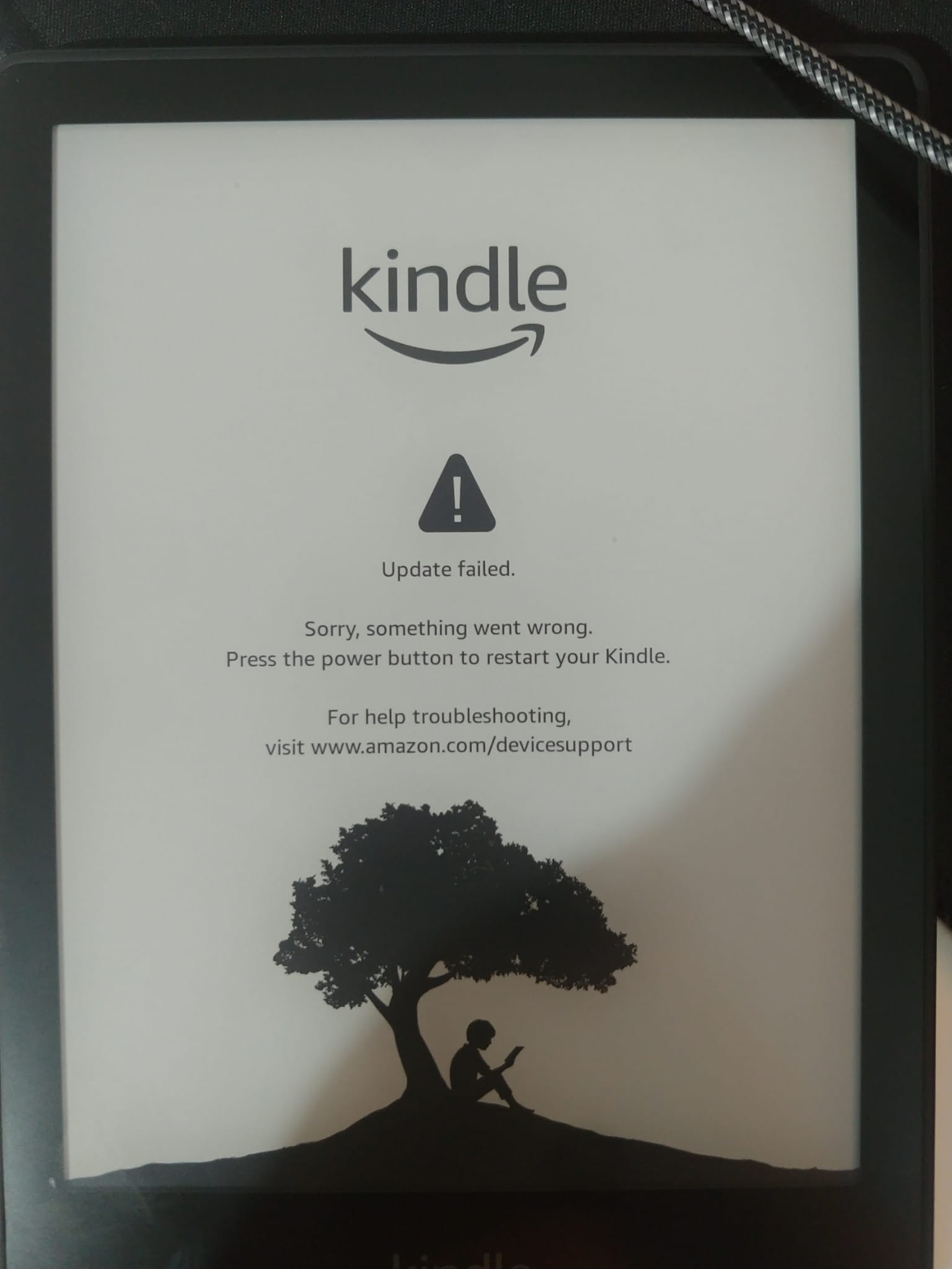

I just tried to install the language hotfix again. I attached a picture of the message.

Old 12-12-2023, 06:06 PM   #611
NiLuJe
BLAM!
NiLuJe's Avatar
Posts: 13,507
Karma: 26047434
Location: Paris, France
Originally Posted by Fossil95 View Post
Could RenameOTAbin have something to do with that, or does it revert to the original state on factory reset or when I installed the 5.16 firmware?
RenameOTA *will* prevent you from using *any* packages via UYK, so, yeah, that *definitely* includes the hotfixes.
The point *ought* to be moot if you've actually successfully reinstalled an official FW since, though.
