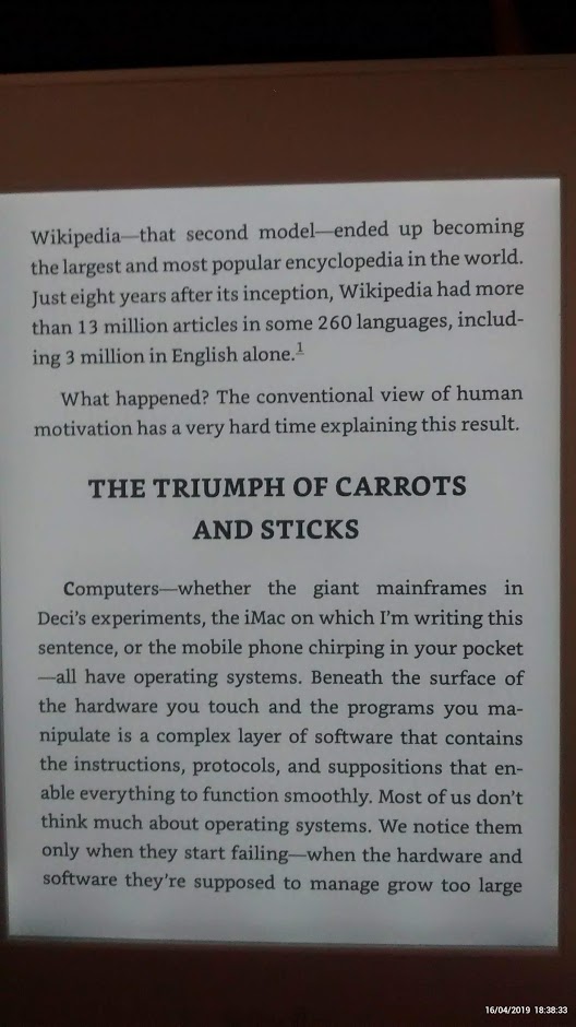

Hi Jhowell. I want to congratulate you for this plugin. It has improved my readings a lot.
But I'm having some issues with hyphenation and there's a possibility it's a kfx format issue (not your plugin's). My Kindle PW3 is not separating the syllables correctly and there's still hyphenation on left align view. Do you know something about this?
The issue about not separating the syllables correctly only happens in english books, but the portuguese ones are perfect - all books metadatas are correctly set on Calibre. The hyphenation on left align view happens on both languages.

Originally Posted by VovoKrall View Post
But I'm having some issues with hyphenation and there's a possibility it's a kfx format issue (not your plugin's). My Kindle PW3 is not separating the syllables correctly...
Hyphenation is performed by the reading device using a hyphenation dictionary for each supported language. I have also seen that English words are occasionally split at incorrect locations. It is up to Amazon to fix that.
The best you can do is to make sure that you have the correct language specified in both the OPF metadata and the HTML content of your book.
... and there's still hyphenation on left align view.
Choosing left alignment does not prevent hyphenation. It will still be used to prevent unusually short lines of text.
If you are familiar with how the edit the source files you are converting, you can turn off hyphenation completely in all or part of the text using CSS. The property to set for this is:
-webkit-hyphens: none
At least to me, it's happening all the time, as you can see on the attached photo.
Sadly, Amazon takes a lot of time to fix some issues. The weird is some people don't seem to have the same problem with their Kindles: https://www.reddit.com/r/kindle/comm...s_hyphenation/
Can it be an issue with the english hyphenation dictionary? The portuguese kfx books are perfect.
I like hyphenation, specially in kfx files, but it makes no sense to hyphenate once the text is left aligned.
Sorry for venting about those issues. It's Amazon responsibility.
Oh boy, it seems that I'm the one separating syllables incorrectly. Can someone confirm me this? xD
