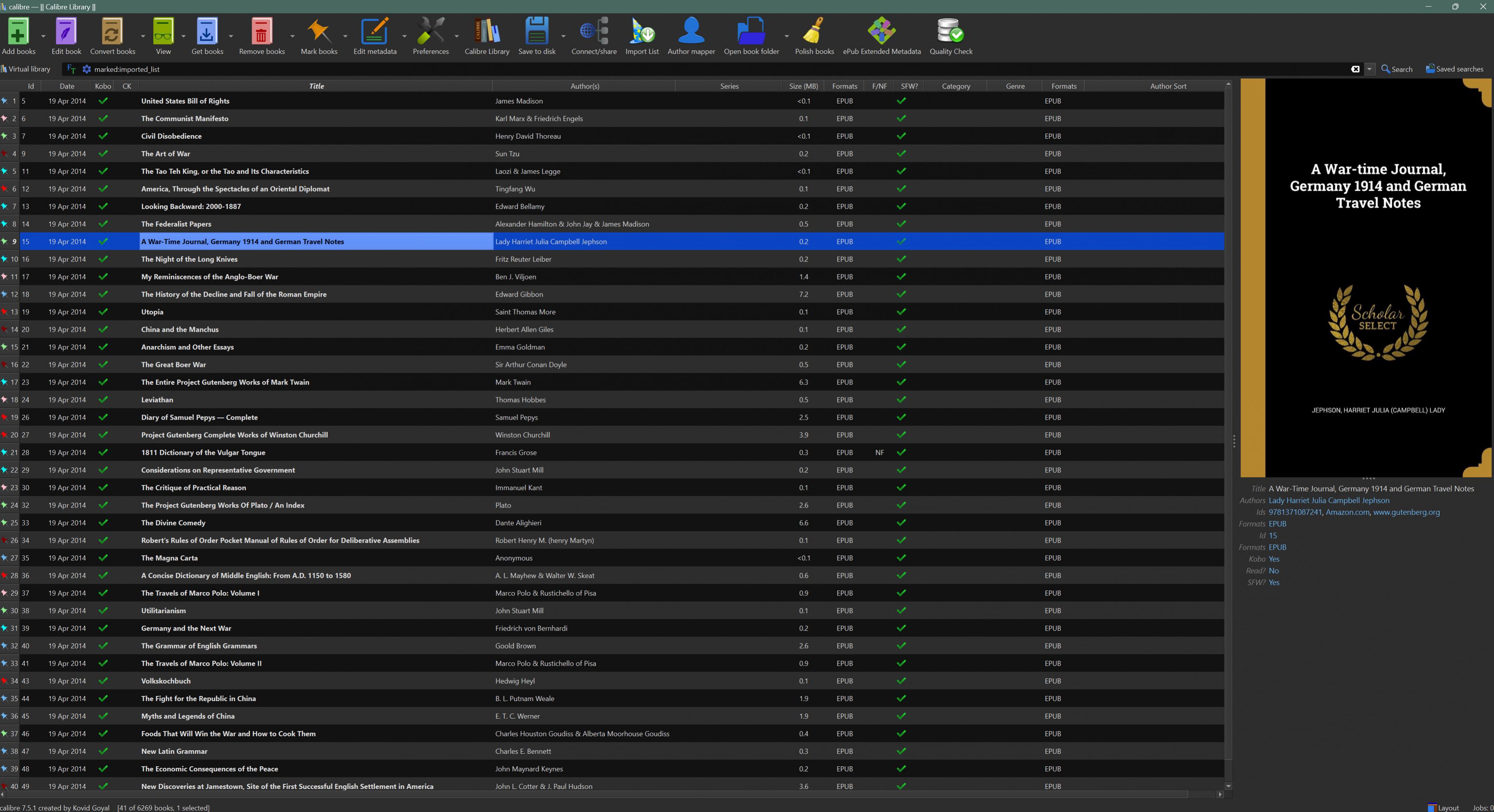

Adding screenshots of the problem after fixing #2 above. I'm trying to map the author_sort to a user-created Author Sort column, I know it's not the default author_sort metadata tag. But I would prefer overwriting the default author_sort via CSV if possible.
I suspect that it isn't possible without changing the plugin. The problem: depending on the API used, changing the author causes calibre to recompute the author sort. If the plugin sets author after author_sort then the recomputation will overwrite what was set. If my guess is correct then the fix would be for the plugin to ensure that author_sort is always set after author.
The most reliable way to do this is an expansion of what you are already doing.
  1. Clear all values from the sort custom column using bulk metadata edit.
  2. Run Import list.
  3. Select all books now having values in the custom column using #column_key:true
  4. Use bulk metadata edit / search and replace to copy the custom column to the author_sort column.
You could use the Action Chains plugin to do all the above steps in one chain.

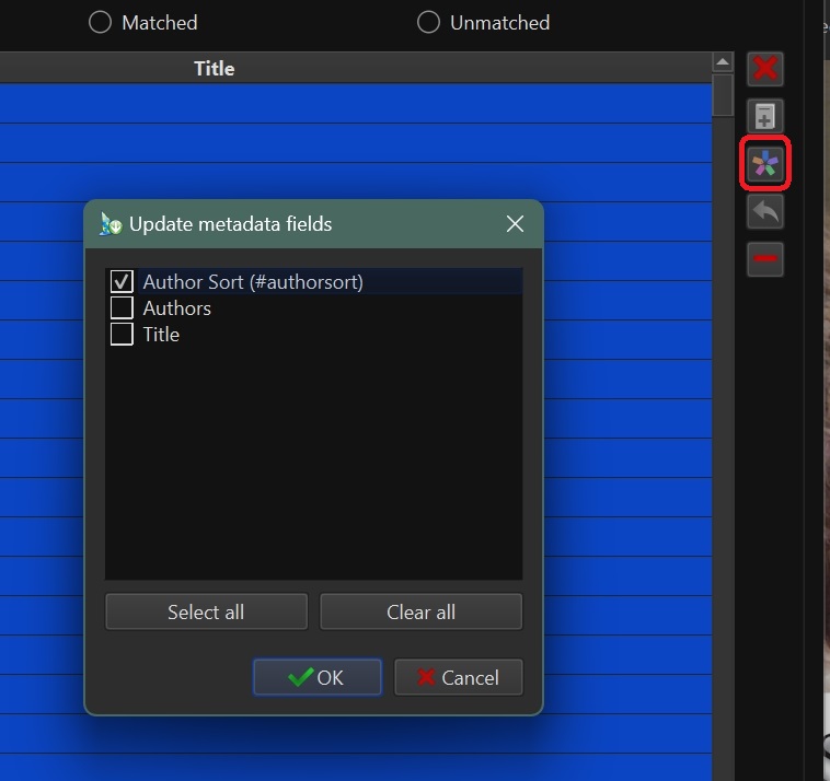

Just as a friendly note to kiwidude, there was a crucial step I was missing and didn't find it anywhere in the documentation.
There's no mention of the "Update Metadata" button in Step 2. As I discovered, unless you select all of the books you want to commit changes to and then click this button and select which fields you want updated, nothing happens. From the UI it wasn't immediately obvious what it did or that it was necessary until I hovered over it with my mouse and saw the rollover text.
It might help future users having the same problem to add this scenario (call it Replacing Existing Metadata, maybe) as a usage example on the wiki.

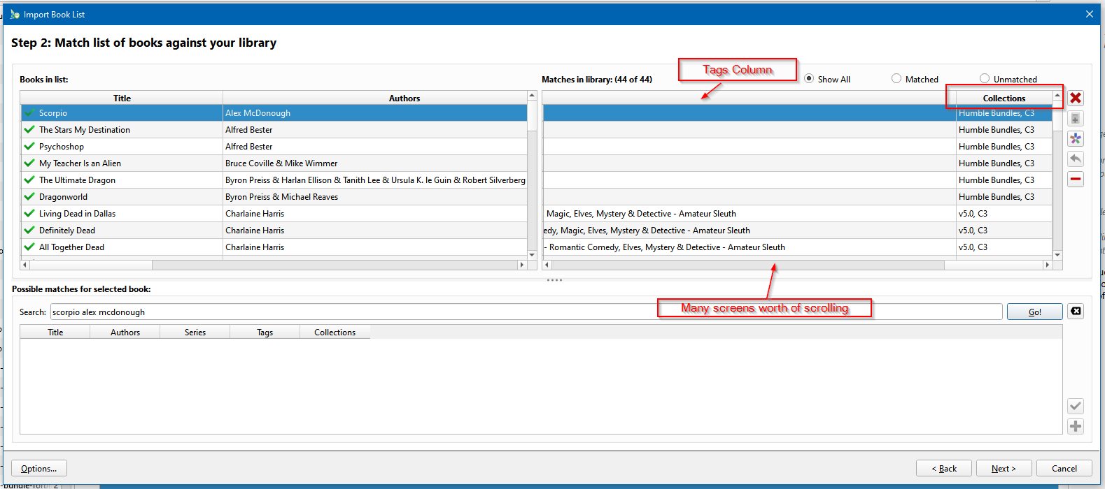

I use a few custom columns, in the attached example I'm using #collections to group things like the various ebook Humble Bundles I pick up.
As you can see the tags column is quite wide, and my custom column is the one at the end. Changing the order of columns in the csv seems to have no effect on the order, any custom column populates to the right of the mandatory columns in that table.

@Wogan - thanks for the screenshot. Without looking at this plugin for so long I didnt realise it is possible to have custom columns appear on the right. Certainly agree it makes sense to restrict default width of that column, I had just wanted to make sure we were talking about the same place. Will take a look later…

This incorporates a number of changes to that Step 2 page to not auto-size the matched book columns, but also adding a splitter between the two grids to make it easier for resizing the screen to allow more flexibility.

Just tested with a few of my different imports and this works great! I love the splitter between the grids, that's a great idea as well!
Thank you!
