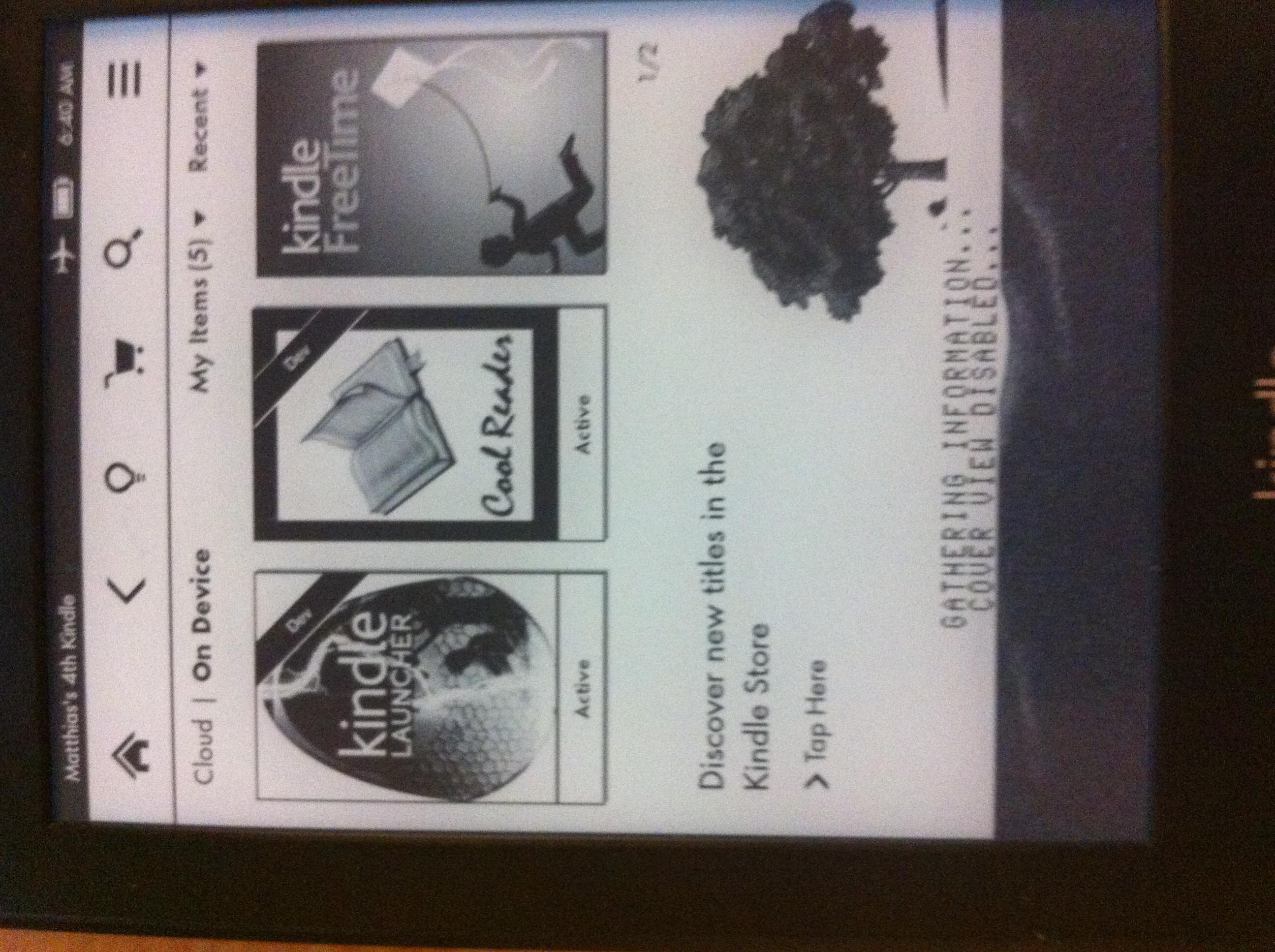

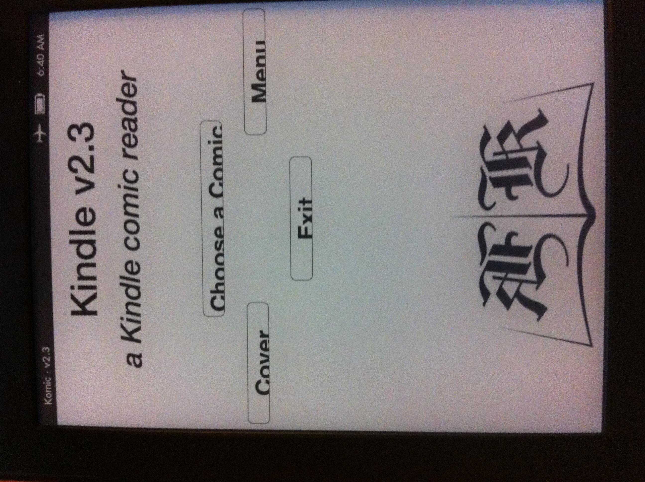

Old 03-11-2014, 05:00 PM   #605
Whitewolf99
Whitewolf99 began at the beginning.
Posts: 10
thanks for your help.
couldn't get it to work in mac osx, but it worked with winscp in windows.
after running the file komic started. i could read comics and change the settings.
problem is after exiting komic i have to restart my kindle since kual and settings menu both give the the whit escreen you see in the screenshots.
