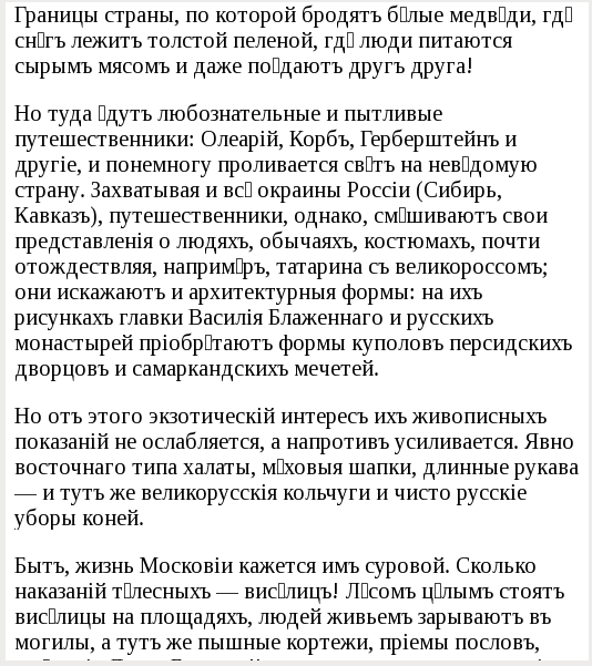

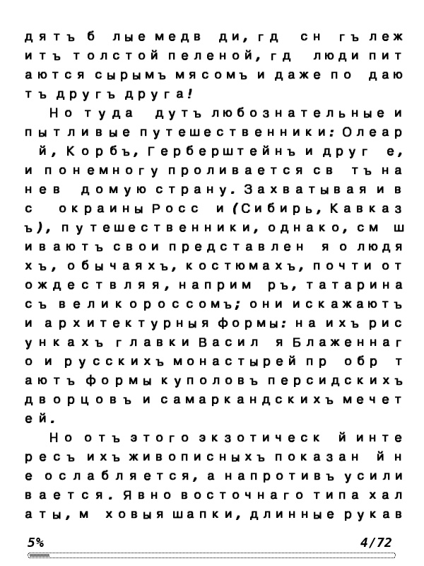

The 1-st. Russian txt files are shown by Chinese hieroglyphs
I tried to convert epub with Calibre - actually, the source have some missing characters due to some old Russian.. but anyway - the first is Duokan, the second a screenshot of FBReader on a computer. ( yes, I had fbkindle, but not right now, but I think it will be close to the computer image on the right )
I would try fbkindle, as I don't know when Duokan would try to improve this.
ID:	68827   Click image for larger version
