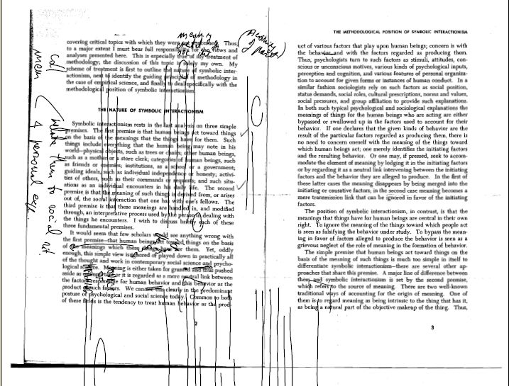

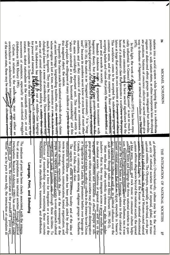

I use 1.7.5 and I absolutely love this program! However, I have come across one annoying bug. I read a lot of scanned books (2 pages of book per one page of scan), and in order to read them on iLiad, I usually rotate pages before I upload them on iLiad so that I can read them in a continuous mode.
However, when I want to merge my scribbles, they are moved to the right, like in the first thumbnail.
I usually could make them merge correctly with iLiad companion, but as of this morning neither iLiad companion nor this program do the merger (the merged pdf has no scribbles - it is as if it hasn't been touched).
So, I tried creating pdf with scribbles only to see if there is something wrong with the scribbles, and what I get is in the second thumbnail.
Any advice? Or fixes?
Thanks!

@rai:
First: sorry for the late reply, I don't visit these forums as often as I used to do, so I didn't see your post before.
About your problem: I just spent quite some time trying to reproduce your problem, I'm unable to simulate it though. I tried with several dcument, rotated or not, continuous mode or not, zoomed or not ... all merged ok.
So, just to be clear:
- Your pdf contains double pages, on their side. So the pdf is like your first attachment (the attachment wasn't rotated), and you use iPdf in the landscape mode?
- You're reading your pdf in continous mode. How do you navigate? with the flipper bar? By 'dragging' the page? Both?
- Is the shift of the scribbles the same everywhere? Or does the shift increase/decrease further in the document?
- Do you read your document zoomed in or out on the iLiad?
If the documents aren't confidential, or you can create a dummy document, would it be possible to post an example of a problematic document with scribbles (pdf+scribble.irx)?
Bert is offline   Reply With Quote
Old 02-10-2008, 10:34 AM   #58
rai
rai began at the beginning.
Posts: 46
Device: iRex iLiad, Onxy Boox M92
Yes, in the landscape mode.
Sometimes the flipper bar, but mostly by dragging the page (as the page is zoomed in, it sometimes goes too far if I use the flipper bar)
As far I can see, the shifts are identical.
Zoomed in (larger page).
Ok, I have uploaded original pdf and the merged pdf and manifest, but I can't upload scribble (it says "invalid file").
File Type: xml manifest.xml (726 Bytes, 953 views)
rai is offline   Reply With Quote
