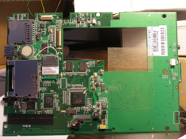

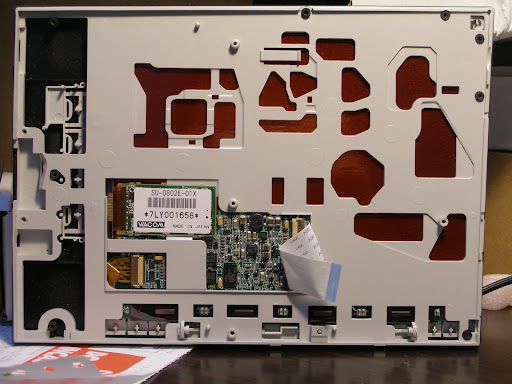

Hi guys...good news on the extraction of a UART (serial port), but not enough.
Me and my professor have opened my Iliad. We found the TP from which you can receive the signals output during boot.
Unfortunately, we have yet found 3 input TP, but none (for now) that accepts signals from which to interrupt the boot and let it continue step by step.
This is the output string shown at boot device.
iRex Technologies Sexy Program Loader for ER0100 series e-reader
(c) 2005, 2006 by iRex Technologies BV
TFFS Volume info unit size: 524288kByte
Reading SysSet info...Done
Hardware: 0007
VCOM: 2CB0
Source drivers: 0012
Initialising DELTA...
Input TP are 104, 113, 518; output TP are 114.
This TP are located on motherboard back, near the "extra connector".
https://wiki.mobileread.com/wiki/File:222115531.jpg
I post detail photos of the TP soon.
I hope the opening of my Iliad and it started without the display device does not have destroyed the chip DELTA screen management (could be a revival of power disproportionate to the chip). Ehm.
WARNING! YOU CAN HARM YOUR DEVICE, WITH ANY OF THIS ACTION!!!
CHILDREN, DO NOT DO IT AT HOME!

Many good news, but... not enough.
First of all, we closed the device and reconnected the screen.
The device has thus been able to finish the boot and we got to the login screen.
The TP functioning input was the No. 113; the presence of TP or their position it may change on a different hardware revision (mine is no.7): in the photos on wiki iliad and those attached at this post, there aren't TP near the debug connector.
At this point, we could then also login via serial port, but did not know the passwoord root (this isn't a standard word). Fortunately, I had already installed a version of Busybox. We have therefore launched a shell directly on the device and cleared the password field in file setup with the password (encrypted) to root.
Then you can login as root via serial port. The blank password is maintained even when you restart the device.
Soon I post a complete boot log file and a how-to for the entire procedure.
Unfortunately, you can't modify the boot process. It will be also difficult to recompile the kernel OpenEmbedded...
But I'll think about later.

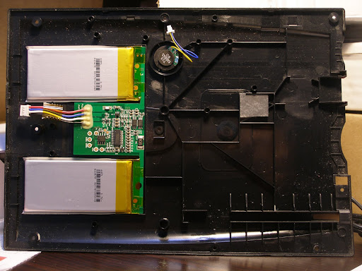

Now the photos...
The input TP is the No. 113; the output TP is the no. 114.
This is the link at photo of mb retro, with the DIY cable.
The link at photo of retro display; the link at photo of front mb; the link at photo of battery board.
The particular of mb retro with DIY cables. Note that the connected cables at TP 111 and TP 518 here are only a trial. The black cable is the cable grounding.
The detail of MB front at debug connector.
