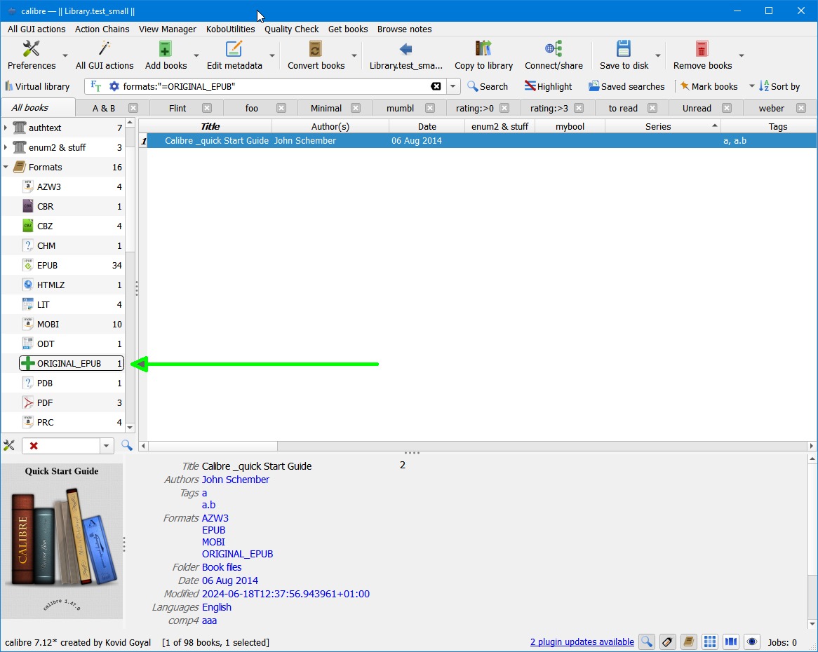

  2. Open the "Formats" section of the tag browser (the pane on the left).

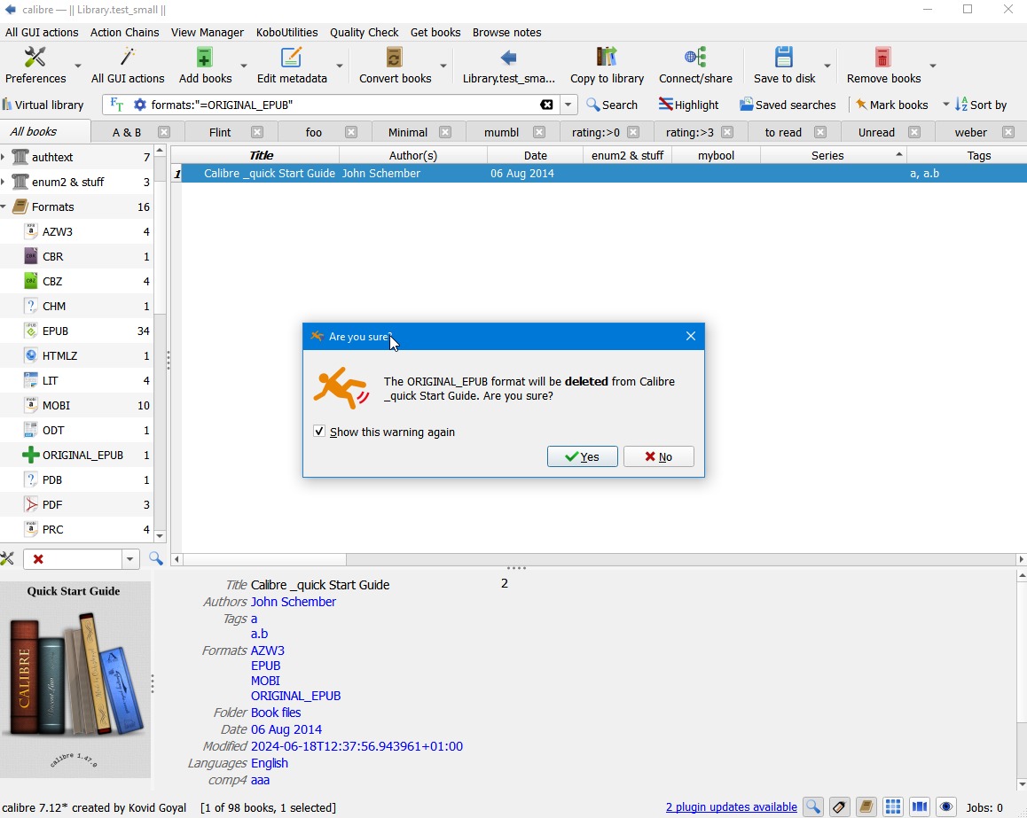

  3. Click the ORIG format you want to remove. A green plus sign will appear and all books having that format will be listed in the book list.

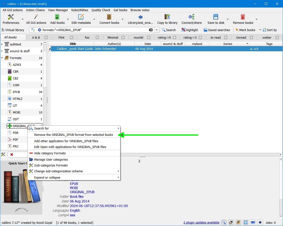

  4. Press CTRL-A to select all the books.
  5. Right click on the ORIG format and select "Remove ORIG ...". In this example it is "Remove the ORIGINAL_EPUB" from selected books".
  6. Answer the "Are you sure" question.

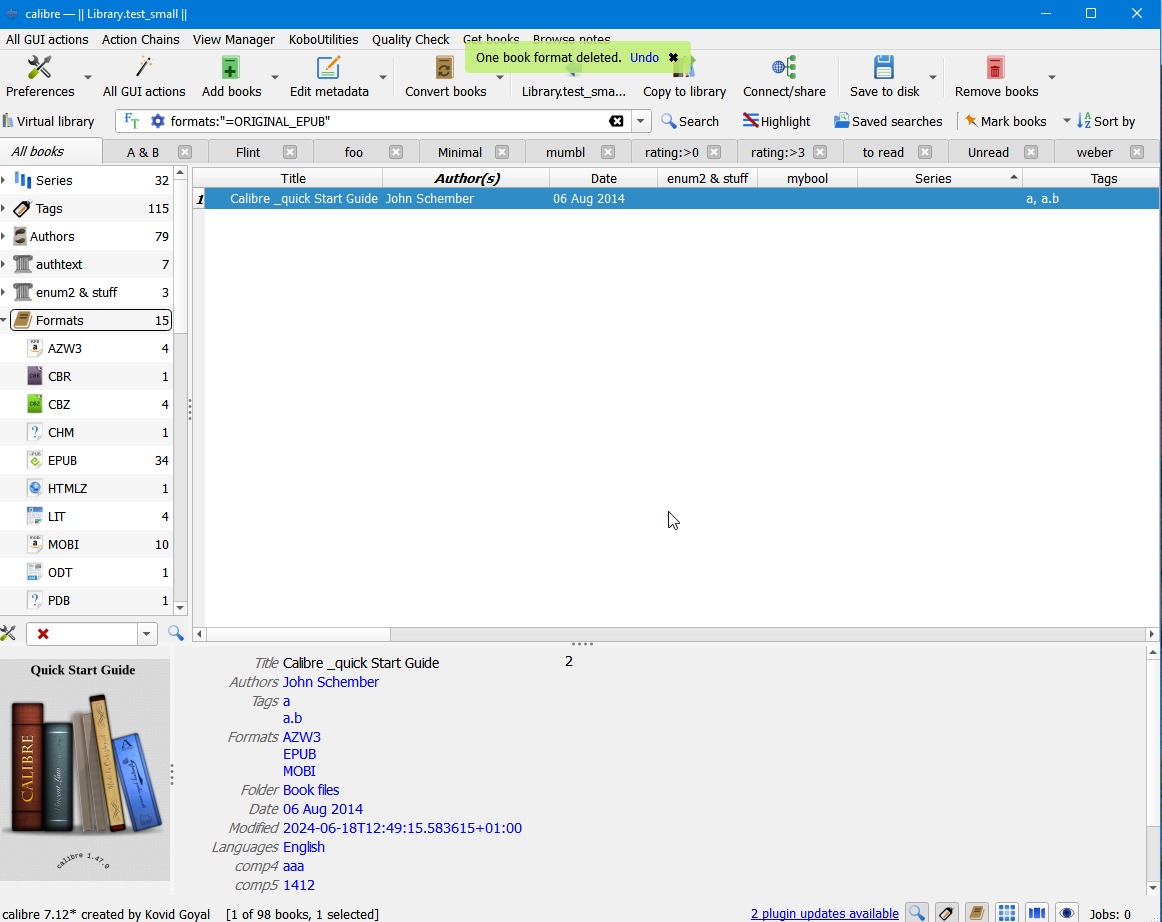

  7. The format is deleted.

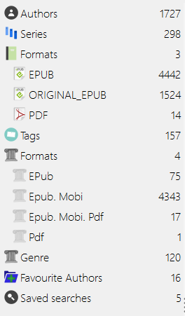

Thanks
Got halfway and chickened out lol
I seem to have 2 Formats Lists to pick from.
When I add a book to calibre I add all the details
Edit Metadata
Custom Metadata
Formats
So some are still saying Epub.Mobi in the box there. Most of my 4000 books
Too many to type te change to just EPub
MRM66 is offline   Reply With Quote

That EPUB.Mobi is a custom column. Once you clean, that may need to be regenerated (if the way it was populated was not from a formula)
The real Formats is the upper one. It is a list style with only 1 value per line.

I would remove the custom formats column. It doesn't tell you anything that the standard formats column doesn't. Even worse, because you must maintain is manually it can be wrong.
