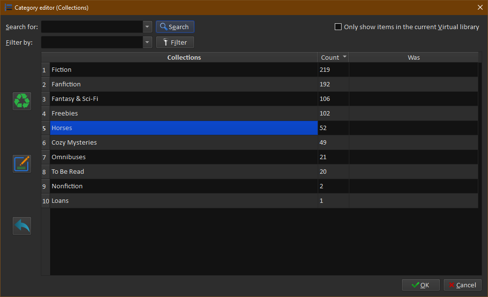

A few years ago there was a case where conflicting case in the shelf/collection names could break syncing:
https://www.mobileread.com/forums/sh...29&postcount=6
https://www.mobileread.com/forums/sh...07#post4174307
Interestingly, purging my collections resolved the sync issue I was having. Only 10 cats, but a few had 100+ books. It's possible that there was some issue similar to the case-sensitivity though.
Attachment 199884
I'm going to nuke fiction and freebies, and look into splitting others to see if it helps.
Sorry if this is something obvious I've missed, but can anyone point me in the direction of the collection editor in the attachment? It looks like it's in Calibre but I don't see it offhand on mine.

Yes, Calibre. I have a custom taglike column that KoboTouch(Extended) uses to generate the collections. The screenshit is the category manager, right-click the column in tag browser and 'manage.'

Thank you so much! That will make my shelving and tagging much easier.
