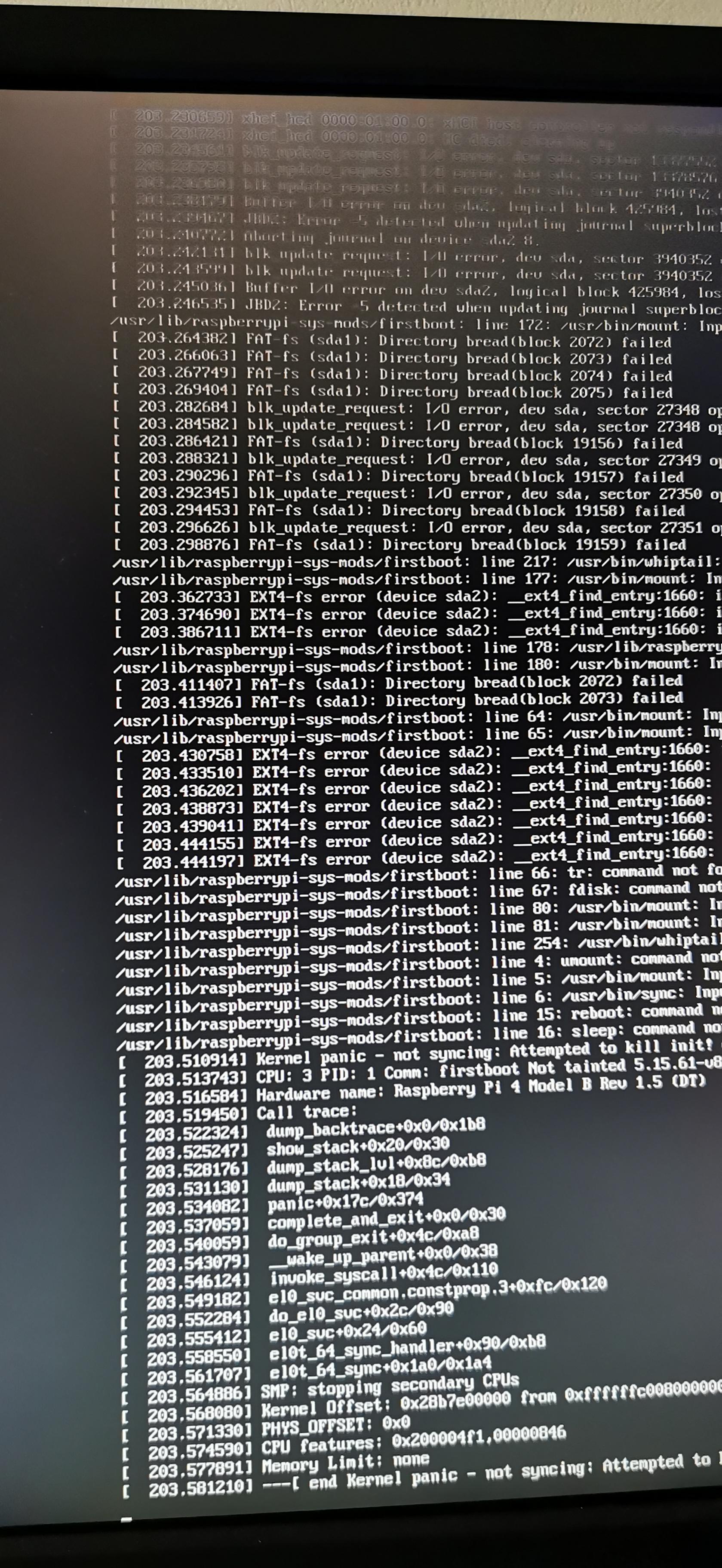

tried it with the 500gb (see pictures above) and two 256gb ssd with following result
No USB Stick used

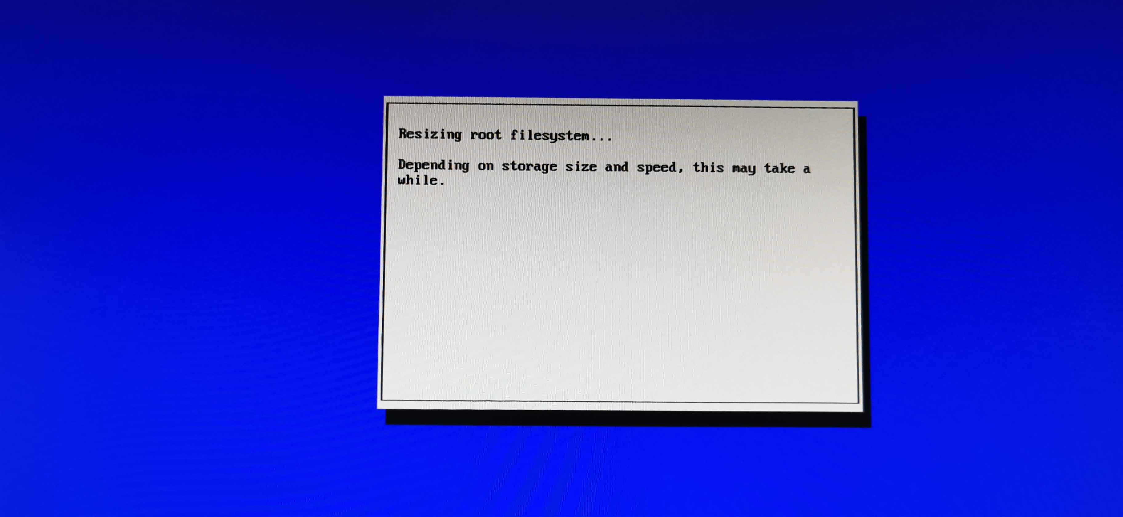

To be honest, I used balenaetcher as well.
Maybe the enclosure is not compatible? Don't know.
And if you try with a Usb stick? (No SSD)
The blue screen is OK!
The next screen not so much.

The second screen shows IO errors on 2 partitions /dev/sda1 and /dev/sda2 (the SSD).
Something is going wrong either writing with balena (but verified!) or reading on the Pi.
Strange..........
Do you have another enclosure (USB 3) for the SSD's to test?

yes (though I don't own an electronic shop) - but both are SABRENT 3.0 Adapter
Due to your arguments (thanks therefore) I finally use the OS from the 128GB Stick
