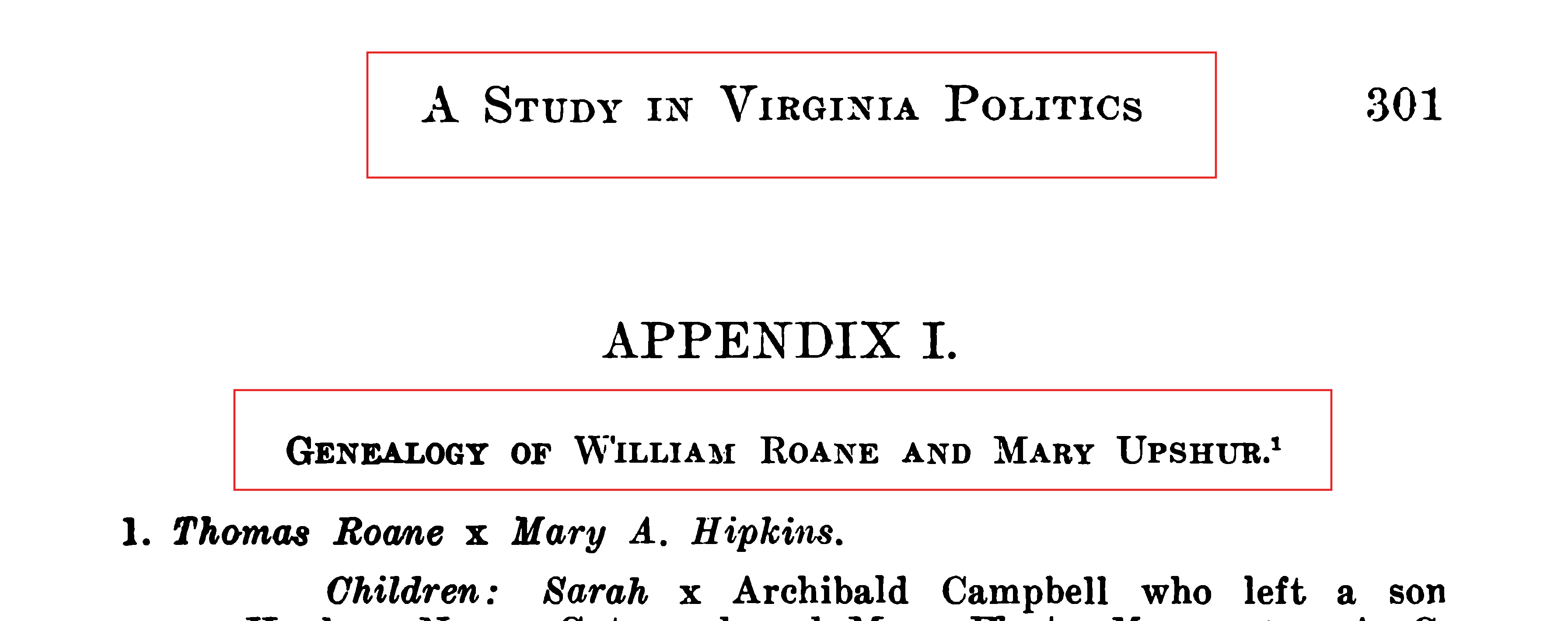

Just wanted to put this example from my latest conversion here:
I think it can speak for itself.
Attachment 196500
I'm sure it does, but apparently I'm deaf. What is it precisely that you're demo'ing here, Tex?

Smallcaps can be used with lowercase AND uppercase letters - and the uppercase glyph is used while still maintaining a font-size difference. It is also using a font that looks like a telegram or an old typewriter.
It looks really nice actually!
Yes, it does look nice, but...never mind. I officially give up.
