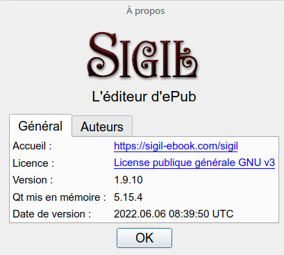

Hi
The Sigil package for Archlinux has been successfully updated to 1.9.10. As far as I can see, it has been built using Qt 5.15.

Device: many
Yes they nicely cherry picked our workaround to the change in gcc compiler generated code introduced by them using lto (link time optimization).

Hi
If you're asking about Qt6 vs Qt5 (considering some of the Qt6 conversations happening here), then yes: Qt5 is still the official Qt of Sigil right now. We're getting very close to officially making the switch to Qt6 (probably Sigil 2.0), but the current default (and expected) builds are still with Qt5.
Manually building with Qt6 was a workaround for the original 1.9.10-1 package that was broken on Arch. Now that 1.9.10-2 is available, there's no need to use the manual Qt6 workaround. Unless people want to experiment--and then we'll take all the beta-testing we can get.
