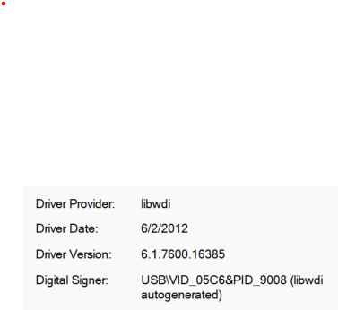

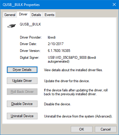

That's very strange. Are you sure that you don't have another EDL utility running or something? Did you reboot the desktop? Not opening is not a slight difference of opinion on protocol like "Could not read". Did you check in Device Manager to see that the driver description is correct?
Edit: You are running this in an Admin capacity? Mmm, it shouldn't be necessary.

Just rebooted the desktop, though I've done that before, with no change (edit: I'm getting the exact same results).
I started down the python path for the EDL, but only got as far as downloading everything and trying (and failing spectacularly) to start it. I (believe) I deleted all the python code, but left python installed, when I found out about your much easier to use exe file. And haven't touched python since a reboot.
My driver description matches your screenshot, except the date.
I am not running any of this with admin privileges.
bassme is offline   Reply With Quote
