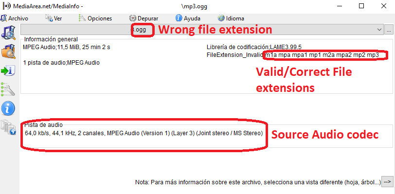

Hello, it could be many things.
But we are going to test the most common problem, that the audios have a wrong file extension.
Maybe not all the parts were originally mp3?
You can try a program to check the real codec of the audios, like "MediaInfo" https://mediaarea.net/en/MediaInfo
(also for android and ios looking in their markets)
If the file extension is incorrect, mediainfo recommends compatible file extensions.
For example, this is an mpeg audio layer3 (mp3) file but I renamed it wrong to .ogg, when I open it with mediainfo it recommends the proper extensions.
P.S: If this doesn't fix your problem, we could try other ways

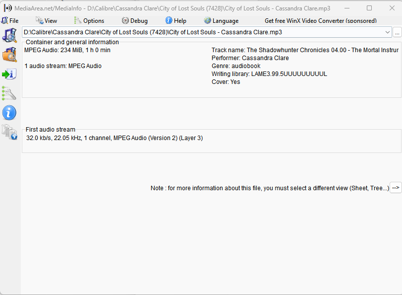

To my knowledge, they were all mp3s (except for a few that I converted with VLC, and I believe those are all fine).
I added a screenshot of the info from the program you recommended. I'm not entirely sure what I'm looking at here, but it's not telling me that the extension is wrong:
But it's also showing the wrong duration on that screen.

Hello, we already know something else.
It tells us that it looks like a correct mp3, but something is wrong in that resulting file or in its metadata, since it also indicates 1h of duration.
How did you join the audios?
The AudioBook_Duration plugin can calculate the duration of all files inside the folder or even .zip or .rar file
If it calculates the duration of the original audios correctly, we have to see what has happened when converting them to a single file.

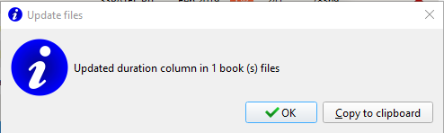

Hi All!
I think I have followed all the directions correctly.
Installed plugin.
Created column for duration (named duration) and set type as "Text, column shown in the tab browser."
Configured plugin with "#duration" in the customize window.
When I click "update the audiobook duration column" it calculates then tells me "updated duration column in 1 book(s) file."
Nothing appears in the duration column.
Please help me figure out how to fix this. I'm using Calibre Portable on Windows 10.

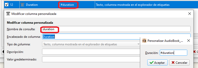

Hi,
Please review the column name and the column name that you put in the configuration.
Indeed, if the name of the column is not exactly that of a valid column, it shows the message that the data has been updated, but since that column DOES NOT EXIST, it cannot update them.
Could you show a screenshot of the custom column and settings, something like that...

Old 12-14-2022, 01:16 PM   #51
Posts: 32,066
Karma: 65709392
do not include the # WHEN YOU CREATE the column.
It is needed when you configure apps or searches .

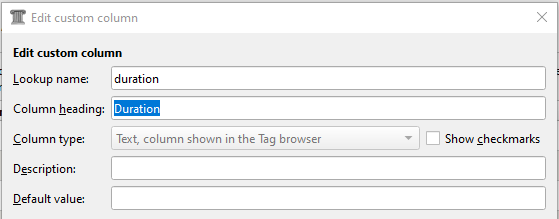

Here are the pertinent screenshots. I only entered # in the Customize Audiobook_Duration window. Calibre added it to the column list.

Hi LazyGirl,
As i can see in your screens, i think Calibre is case sensitive and you should use "#duration" instead of "#Duration"

This was the problem! Thank you so much wiso!!!
