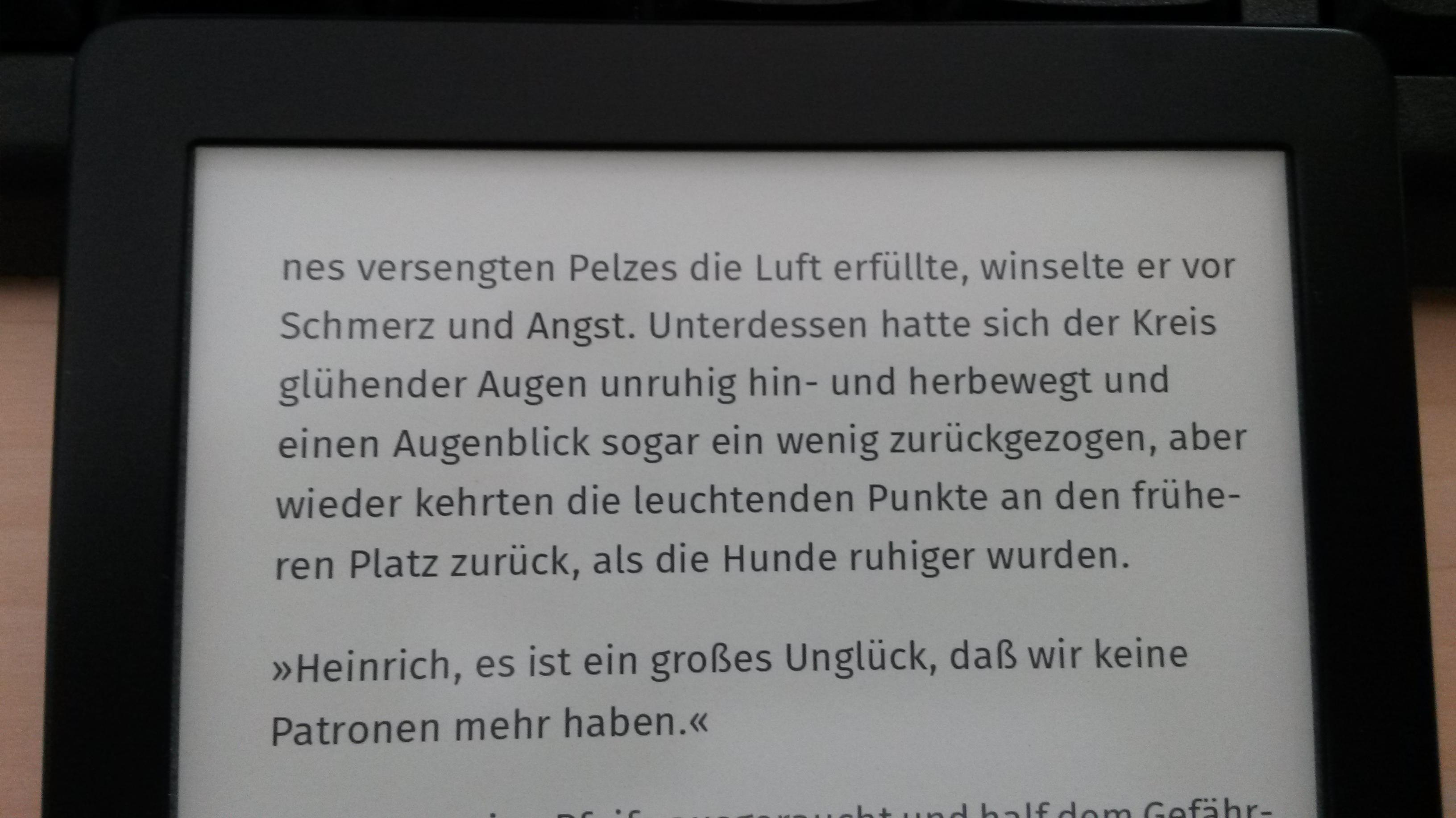

@genfersee
You can use TWRP to install the ready-made update.zip.
This is the official firmware 13.2.1 for Shine3 with the modified EPubProd.apk, as you wanted.
