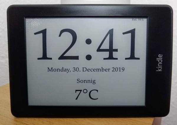

I was getting about 3 days with python sleep() and about 8 days with rtcwake -m mem.
And that's exactly what is to be expected:
1600mAh battery, using it for 5 secs @ 100mA every minute results in 8 days runtime.
That's why I have connected a charger cable in the meantime. Doesn't hurt.
I am using a simple shell script in combination with fbink and suspend to RAM.
And a little bit of weather info, of course ;-)
https://github.com/mattzzw/kindle-clock
