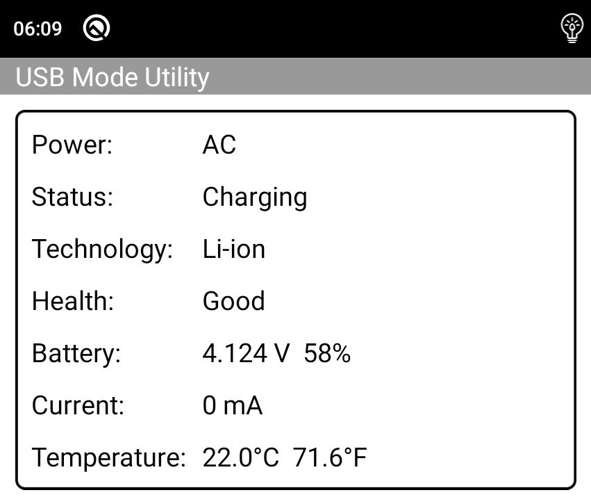

Well, swapping batteries confuses things even more.
If it says 100% charge, double check that the battery really has 4.2V or so.
It doesn't log or graph it, but my UsbMode.apk (in the sig) will at least show you the real battery voltage.

Thanks, got your tool. It shows 4.146 V when 100%. Unfortunately it can't measure the current, always display 0 mA.
Yes, the Android system allows places for these values to be stored and accessed but there is no guarantee that the underlying hardware and firmware supports them.
When doing real analysis of a device I substitute a special power supply for the battery so that I can see the current drain at a fixed (and not drooping) voltage.
Those tiny push-in flexible printed circuit board plugs (as used in the Poke3 battery connection) are a pain and I don't have any breakout adapters for them.
Was that 4.146V with USB plugged in or not?
Right now, I'm 4.266V = 84% plugged in, 4.197V with the plug out.

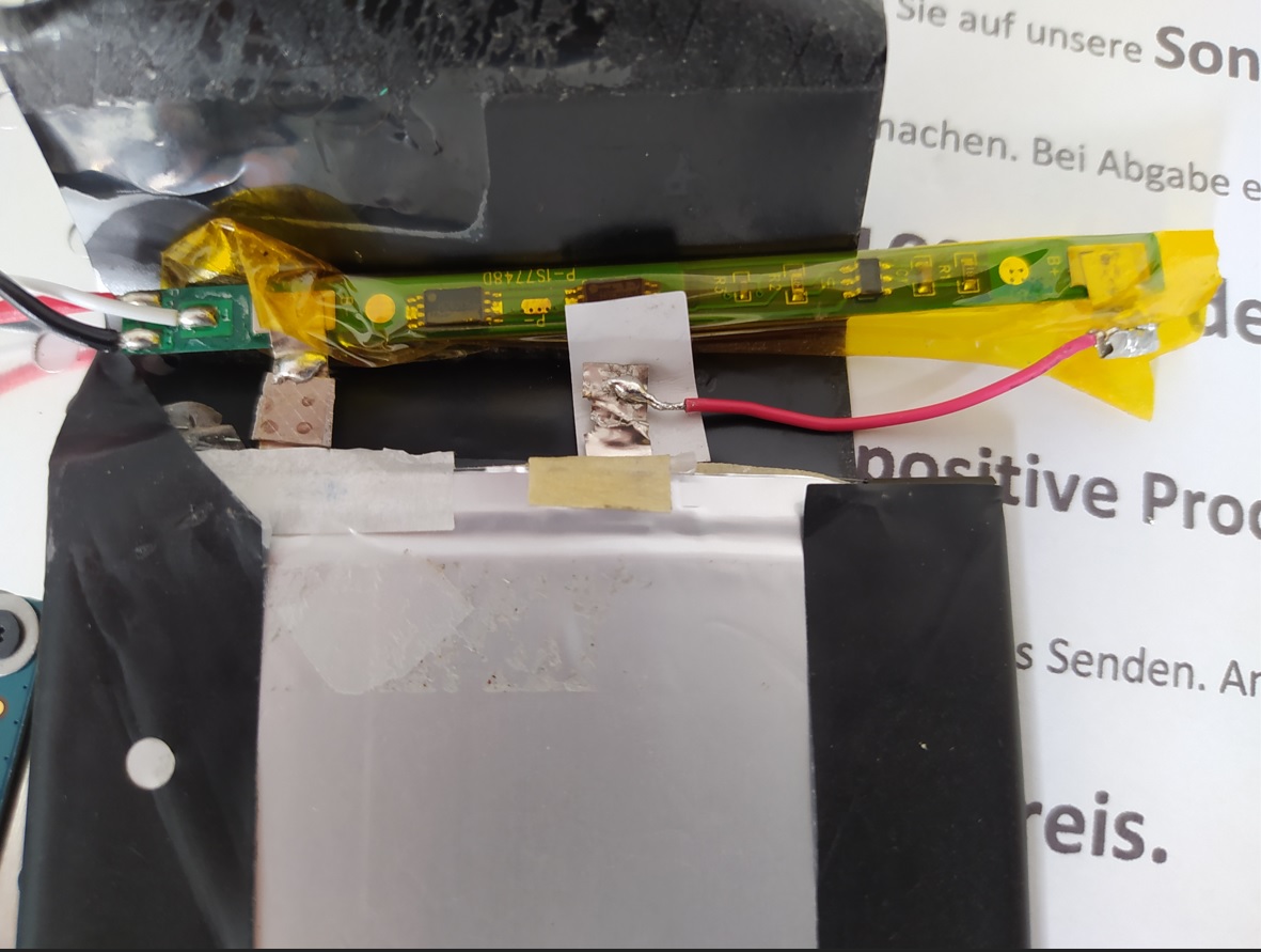

Completely agree about the soldering. It actually took me the largest amount of time and trouble. At the end looked +- satisfactory (s. image).
Otherwise, the reader can be used again, great!

Soldering those tabs can be difficult. I'd try to make sure that they're tinned properly first. Extra liquid flux might help. Heck, aluminum can be soldered with the correct technique.
