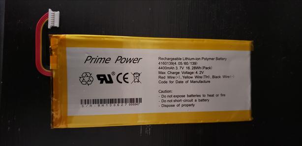

Well it looks like my original Kobo Arc battery has bit the dust. 8 years of total lifetime and it has been resting for several of those.
Android 4.0.4 is really showing its age.
I forgot to take a picture of the battery while I had it open but found one online. A replacement is not easily found and is really not worth it at this point in time.
It was a fun run with this tablet. I learned a lot about Android development using this.
