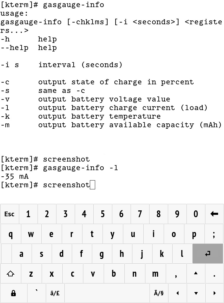

Originally Posted by Sol Arkite View Post
Frankly, I’m doing my best.
We can neither see over your shoulder nor channel into your mind.
If you haven't eliminated a possible lead to the problem by the information already provided, then we have to ask for more information.
Your device is jail broken.
Now gain command line access, your choice:
Install kterm, or
Install ssh, or
Use the ;log runme search bar command to run a scripted command (there are examples posted here).
With access to the command line, type these characters followed by the 'enter' key:
gasgauge-info
The system will reply with a short help message, choose the option to include with the command from that message list.
The command will report your select information on the battery usage and charging system operation.
That is all there is to it.
See below (-xx : discharge, +xx : charge)
