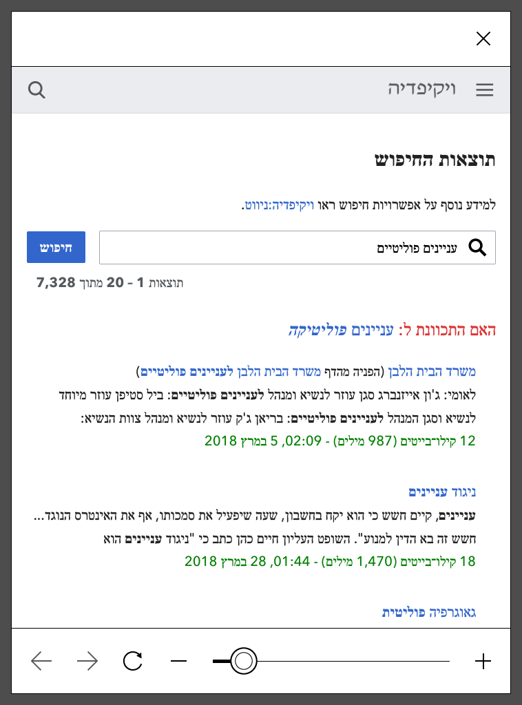

Patch `Wikipedia Search language`
libnickel.so.1.0.0.patch
The patch set the search language in Wikipedia.
Replace the "en" (in both the replace_string lines) to the language code you want. For example English is "en" (set as default), for German is "de", for Russian is "ru".
<Patch>
patch_name = `Wikipedia Search language`
patch_enable = `yes`
# Multi version patch: 4.8.10956+
# The patch set the search language in Wikipedia.
# Replace the "en" (in both the replace_string lines) to language code you want.
# For example English is "en" (set as default), for German is "de", for Russian is "ru".
find_base_address = `\0https://%1.m.wikipedia.org/wiki/Special:Search\0`
replace_string = 0000, `\0https://%1.m.wikipedia.org/wiki/Special:Search\0`, `\0https://en.m.wikipedia.org/wiki/Special:Search\0`
find_base_address = `\0https://%1.wikipedia.org/wiki/Special:Search\0`
replace_string = 0000, `\0https://%1.wikipedia.org/wiki/Special:Search\0`, `\0https://en.wikipedia.org/wiki/Special:Search\0`
</Patch>
the second picture show wikipedia in Hebrew language.
Completely off-topic, but I was jolted that right to left in Hebrew doesn't apply to numbers, or at least treats numbers as a whole, not digit by digit. I assume words still are right to left character by character, but what do I know.
