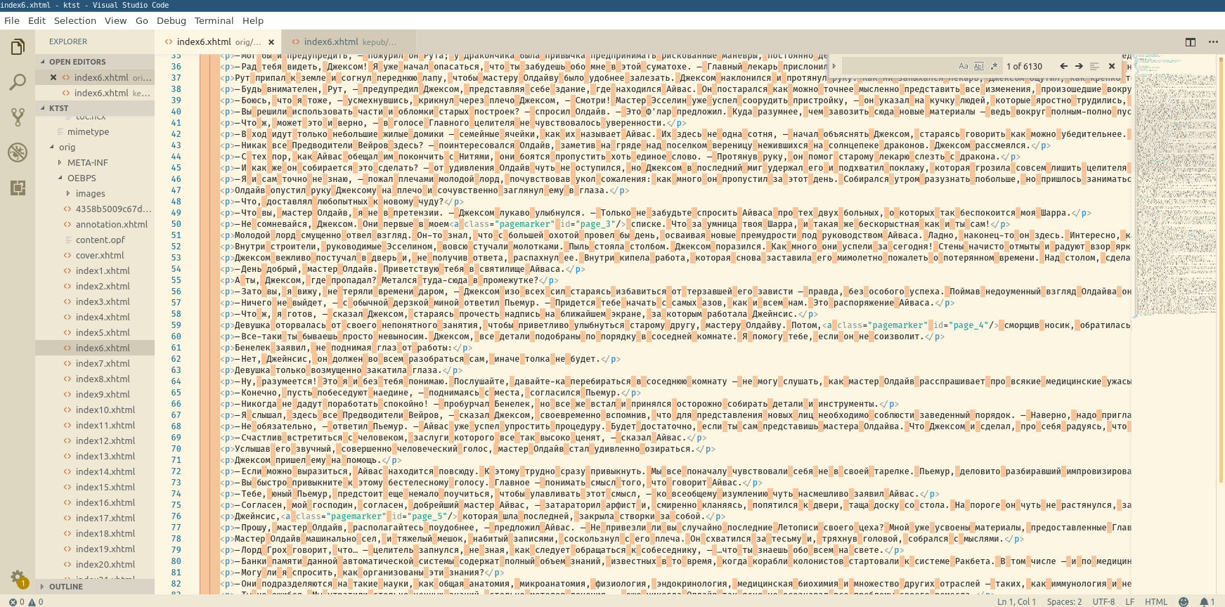

Location: Ontario, Canada
I received your PM. The issue is that the spaces are actually non-breaking spaces. See the screenshot (I searched for ordinary spaces).
The reason why the book worked fine before the conversion is because some parsers would ignore that was, as it should be escaped. Kepubify will try to make non-compliant html compliant (and as a result, converts nbsp chars to their escaped equivalent).
