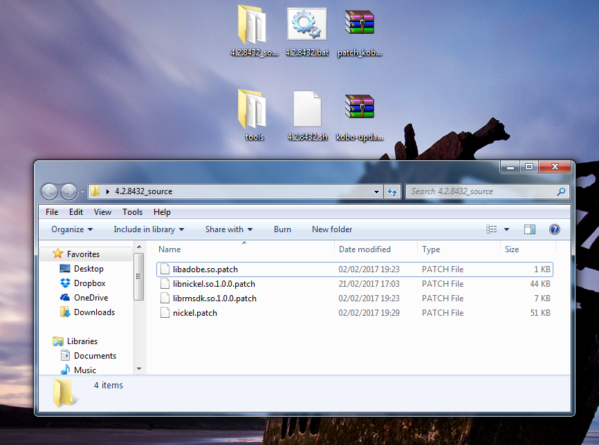

This is the files on my desktop.

I can't create a KoboRoot.tgz file. I'm using W7 and when I double-click the 4.2.8432.bat I get the following error:-
there is no such archive
ERROR Cannot find or extract "libadobe.so"
Did you copy kobo-update-X.X.X.zip to C:\Users\Owner\Desktop\4.2.8432_source?
Press any key to continue...
The file libadobe.so is in the source folder on my desktop (which is where the zip was extracted too), I haven't touched that file at all. I've only edited the libnickel.so.1.0.0 file.
Can anyone help please?
Copy kobo-update-4.2.8432.zip (make sure it's the correct version for your Kobo) to the 4.2.8432_source directory. Delete any other files from that directory that do not end in .patch. Then you can run 4.2.8432.bat and if the patches are correct, it will work.
Thank you, that's where I was going wrong, i'll amend my notes for the future.
