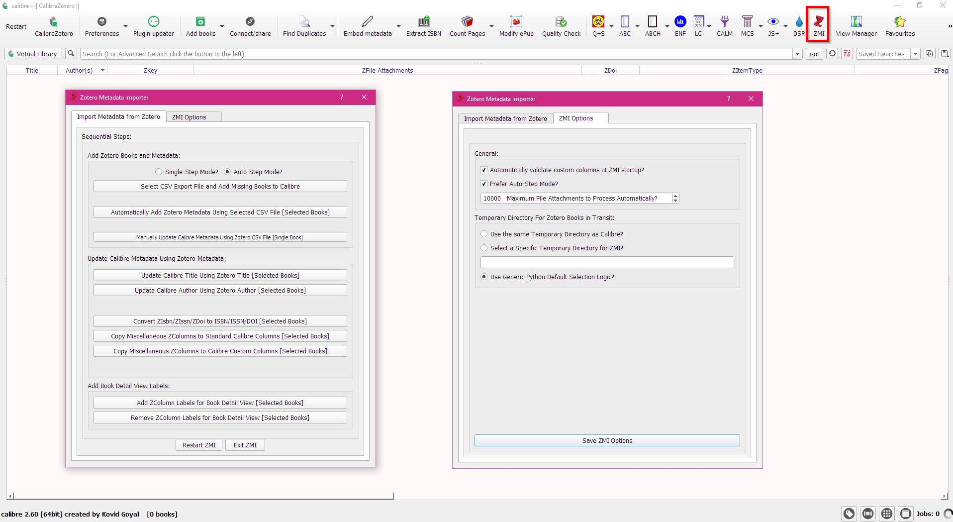

Version 1.0.14 - 2016-06-30 Major Enhancements.
ZMI is a week old today. Thanks to the long-time users of Zotero, with this version it becomes highly usable.
See the image below.
Remember to hover your mouse over each area and widget of the window so that you may read the ToolTips.
The ToolTips are the User Guide.

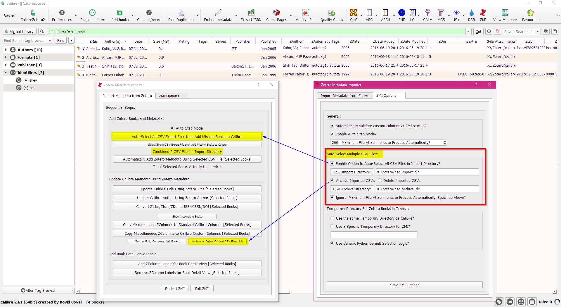

Version 1.0.23 New: 'Auto-Select Multiple CSV Files' then Auto-Process all of them
Version 1.0.23 - 2016-07-07 New: 'Auto-Select Multiple CSV Files' then Auto-Process all of them simultaneously. Afterwards, archive or delete the original CSV files.
See the attached image.
DaltonST

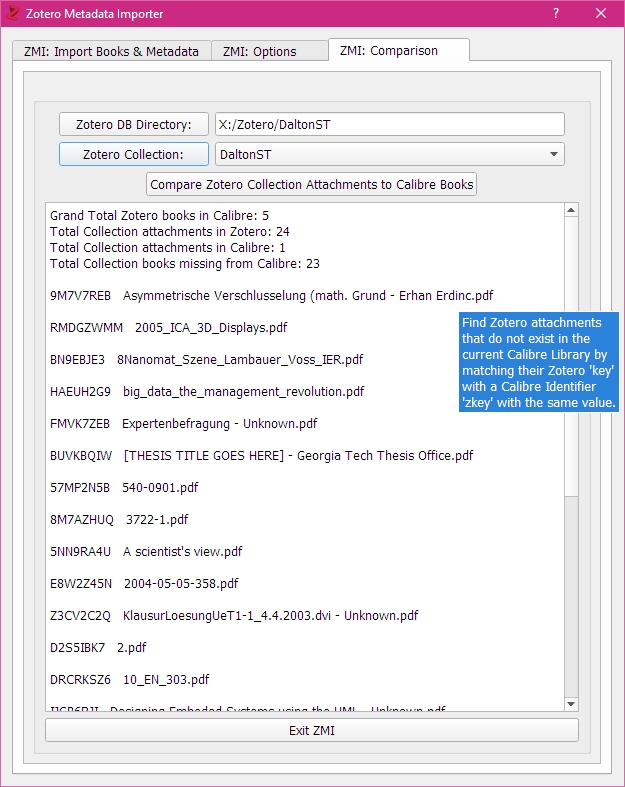

New: Compare Zotero Database to Calibre Database
Version 1.0.26 - 2016-07-15 New: Compare Zotero Database to Calibre Database to find Zotero books missing from Calibre.
I have tested this with both Standalone Zotero using Firefox, and Firefox Zotero. Sometimes Zotero puts an exclusive lock on its database. If that occurs, ZMI will tell you, and will advise you to simply exit from the Zotero software so that it releases its lock.
Version 1.0.27 - 2016-07-15 Miscellaneous enhancements; New Calibre Identifier of 'zcollection' is updated for books with their matching Zotero collection name automatically whenever the Compare function is executed for their Zotero collection.
DaltonST
