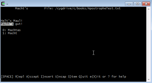

Maybe as workarround you can use hunspell command line tool. I did some mini test with cygwin (windows) a few days ago.
hunspell -d de_DE_OLDSPELL /cygdrive/c/books/ApostropheTest.txt
(see -H The input file is in SGML/HTML format. )
hunspell(1) - Linux man page
https://linux.die.net/man/1/hunspell
