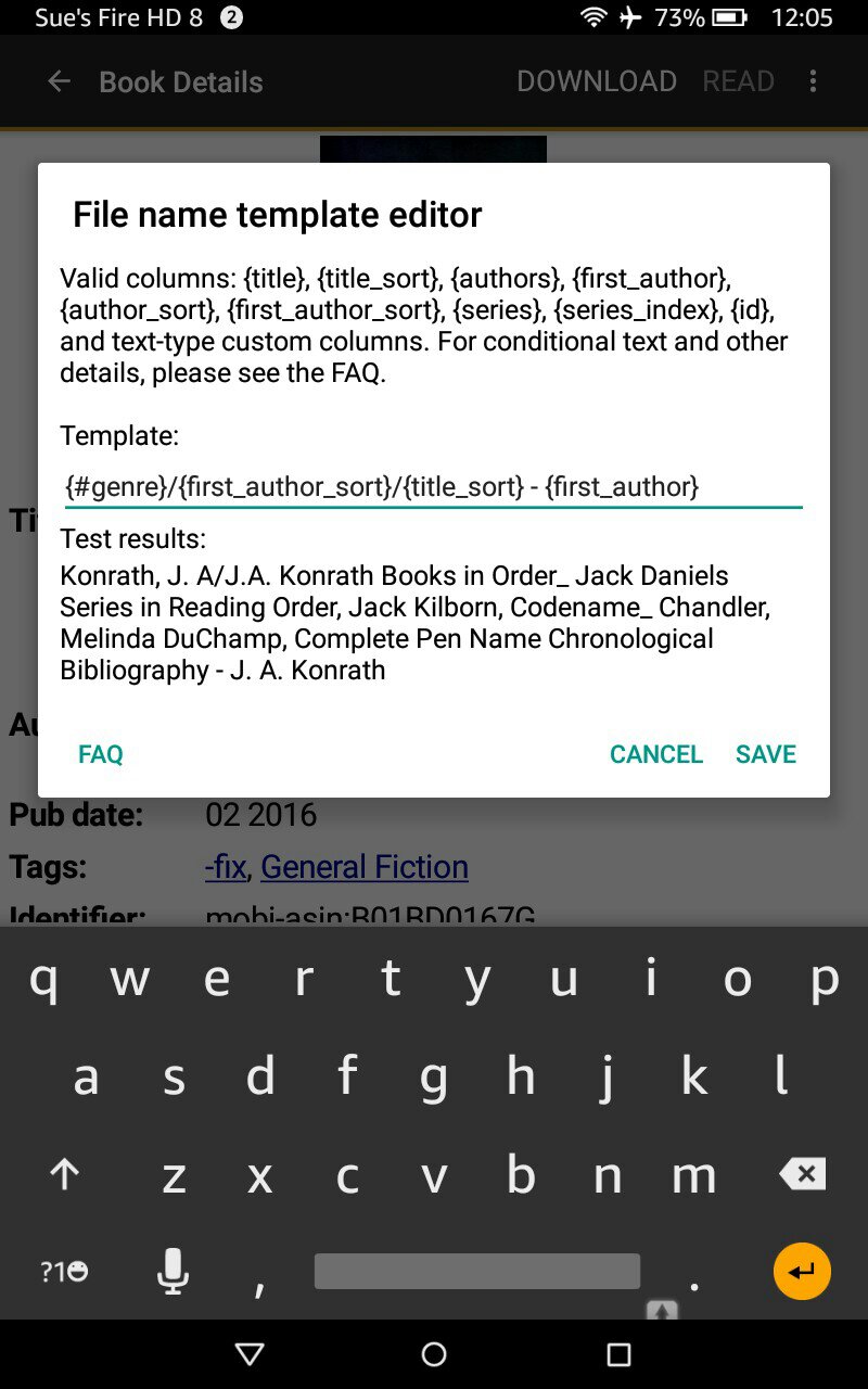

Substituting an underscore for a period is simply not working for me. I have tried with new books, old books, Dropbox, internal sd, external. See screenshot of template editor.
