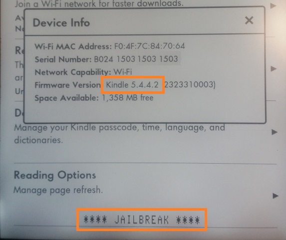

Was looking forward to a day disassembling my new (used) kindle.. but it arrived with old software so it was a 2-minute jailbreak... eat your hearts out!
Name:	new used kindle.jpg

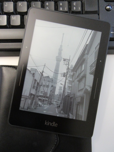

Success with Kindle Voyage
I've been waiting for this since the Voyage came out. I had hacked all my older Kindles and reverted to using my Paperwhite because I missed my own screensavers so much and couldn't put up with the stock ones. When I saw this tutorial and that it didn't involve using Linux I decided to take the plunge.
Some notes:
1. The Kindle Voyage is really easy to open (which was kind of a concern for me beforehand).
2. Soldering the serial cable seems next to impossible to me - I used the pin method which works fine if you fix everything tight with tape (you do not need to see the screen for hacking and installing). - I put three pairs of reading glasses on on top of each other to position the pins correctly...
3. I ran into the same issue as stupidhaiku, the boot also stopped with the line "sock_init 1888". Thanks to his post I was able to proceed and login.
So I am a very happy owner of a jailbroken Voyage (FW 5.6.1.0.5) with custom screensavers ;-) Thank you all very much for your work and your posts!
Lord Taku is offline   Reply With Quote

Originally Posted by MrCaringi View Post
Great job! any pictures? :P
On taking the Voyage apart there are links to pictures and a description at the beginning of the 2nd part of the OP, also see this video: https://youtu.be/fHM6tdHeCiE. For me removing the top bezel worked best starting at the top corner and then working my way towards the middle and then to the other corner (not at the side like in the video).
On the pin method of connecting the serial cable there are links towards the end of the 2nd part of the OP.
