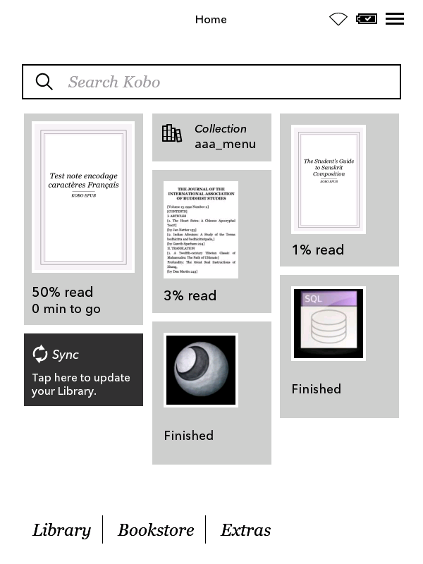

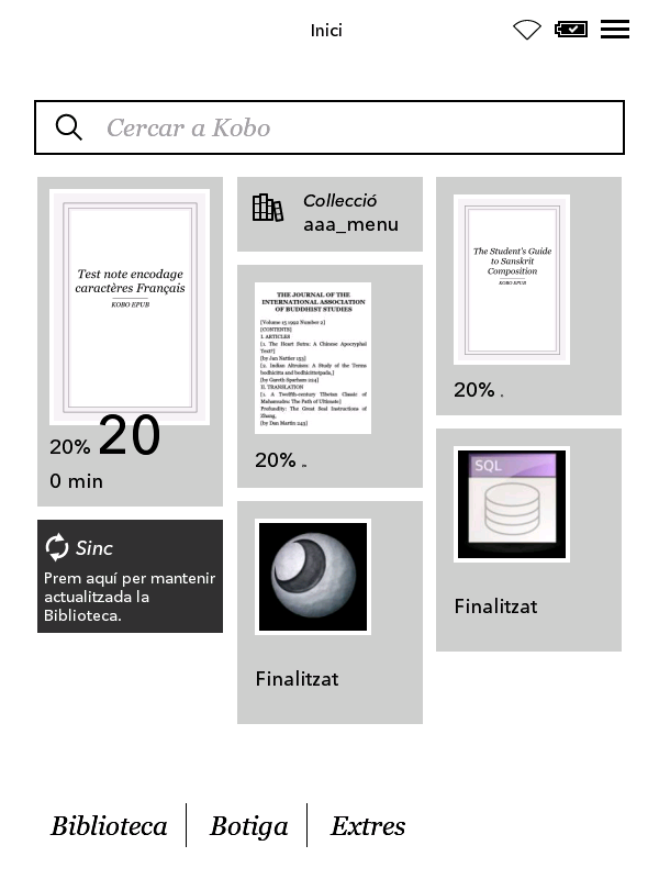

I have to remove the BOM anyway, so that does not make a difference. As for your trial to eliminate the small font size, this seems not to work as expected (I upload the patch nonetheless), see the attached screen_20150417b.png. The main problem (seen in the picture of post #41) seems to me to be the fact that html tags are interpreted as normal text. This explains also why the font size (set in the span tag) is not respected. Why the html tags are not treated as such in this position, I do not understand. I tried something different. That seems to work on Touch (screen_20150417c.png), maybe it is working on your reader too. If you see again html code, could you please remove all other patches (like the Bad eyes patch) so that we can narrow down the possibilities?
Please take over all changes of post #40 into your xlsx file. Watch out for "\ n" (2 cases), and replace them by "\n".

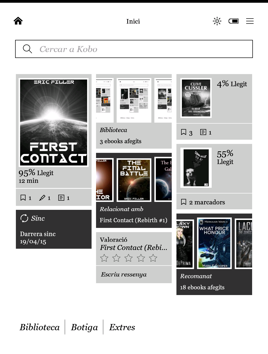

The modification you've done works well. It looks perfect and it has the word "Llegit" that I could not put. Fantastic.
thank you very much.
My apologies.
