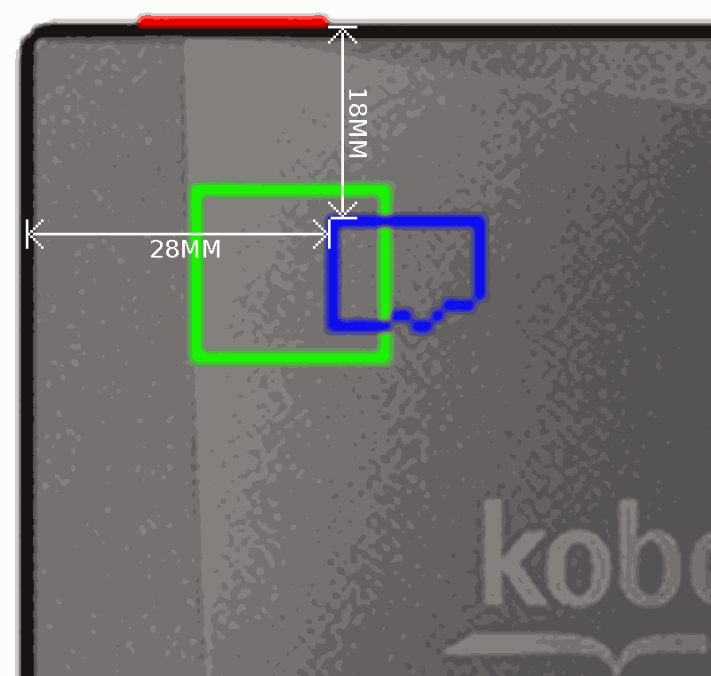

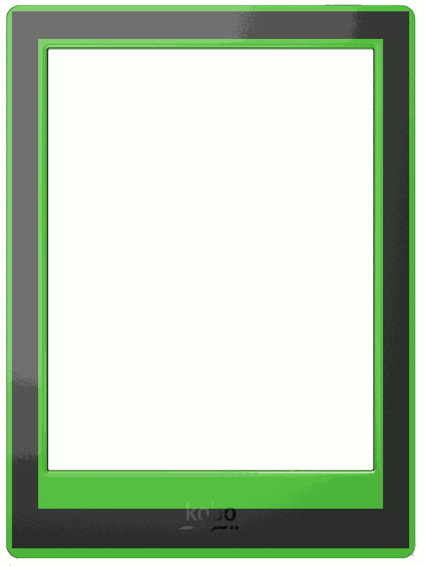

An approximation of where to expect glue. If you have to open it, I think it's best to start from the top left or top right corner, and not from the bottom since there's more glue and more sensitive bits down there (LED, light layer). Maybe warming it up a little would also help to soften the glue, I don't know. It was rather cold when I tried it and it did not come off easily.
As for the exact position of the SD card... the top left corner of the SD card is 18mm from the top and 28mm from the left, so it's pretty much aligned to the power button, which is 11mm-28mm from the left, so the SD card starts where the power button ends. And the SD card ends where the Kobo logo starts (on the X axis). It does not actually reach into the Kobo logo as the illustration makes it appear, the scale is quite inaccurate, sorry...

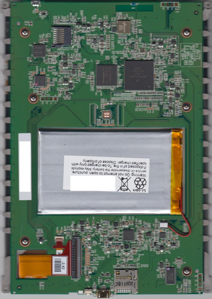

Please get a GOOD camera and retake the photos. Why do photos like this have to be poorly taken?
No cameras were involved while capturing this image.
(Does anyone have suggestions on producing a cleaner scan? When looking at the full resolution image, it looks like the board was vibrating. Or is it just a product of the quality of the scanner, since my old scanner definitely produced better results.)

Originally Posted by BWinmill View Post
(Does anyone have suggestions on producing a cleaner scan?)
You'd need a CCD scanner; nowadays CIS is more common (particularly with all-in-one printers) but it lacks any kind of depth perception so you get blurry results when scanning objects such as this.
If you can get an old Epson 1260 (or whatever) from Ebay, around $10 if you are lucky... that's what I used to make scans of the iriver Story HD which turned out fine, if a bit too dark... but I don't have that device anymore so...
frostschutz is offline
Old 12-12-2014, 10:17 AM   #50
BWinmill
Nameless Being
Now that I know what to look for, that is definitely the cause. Thank-you.
You DO NOT scan it. You use a good digital camera to take a good photo. It's not hard to do. Why does it seem so hard for some?

Jon: Stop the rant. It probably means they don't own a "good digital camera". They used the tools at hand.
I do have a decent digital camera but it is a fair bit easier to use a scanner. It's simply a matter of placing the board on the scanner bed and letting the software do the work. There's no need to worry about the lighting, stability, or distortion (because it is placed at an angle in 3-space instead of an angle in 2-space).
A scanner is definitely a better tool for the job, assuming, of course, I still had a good scanner on hand.
