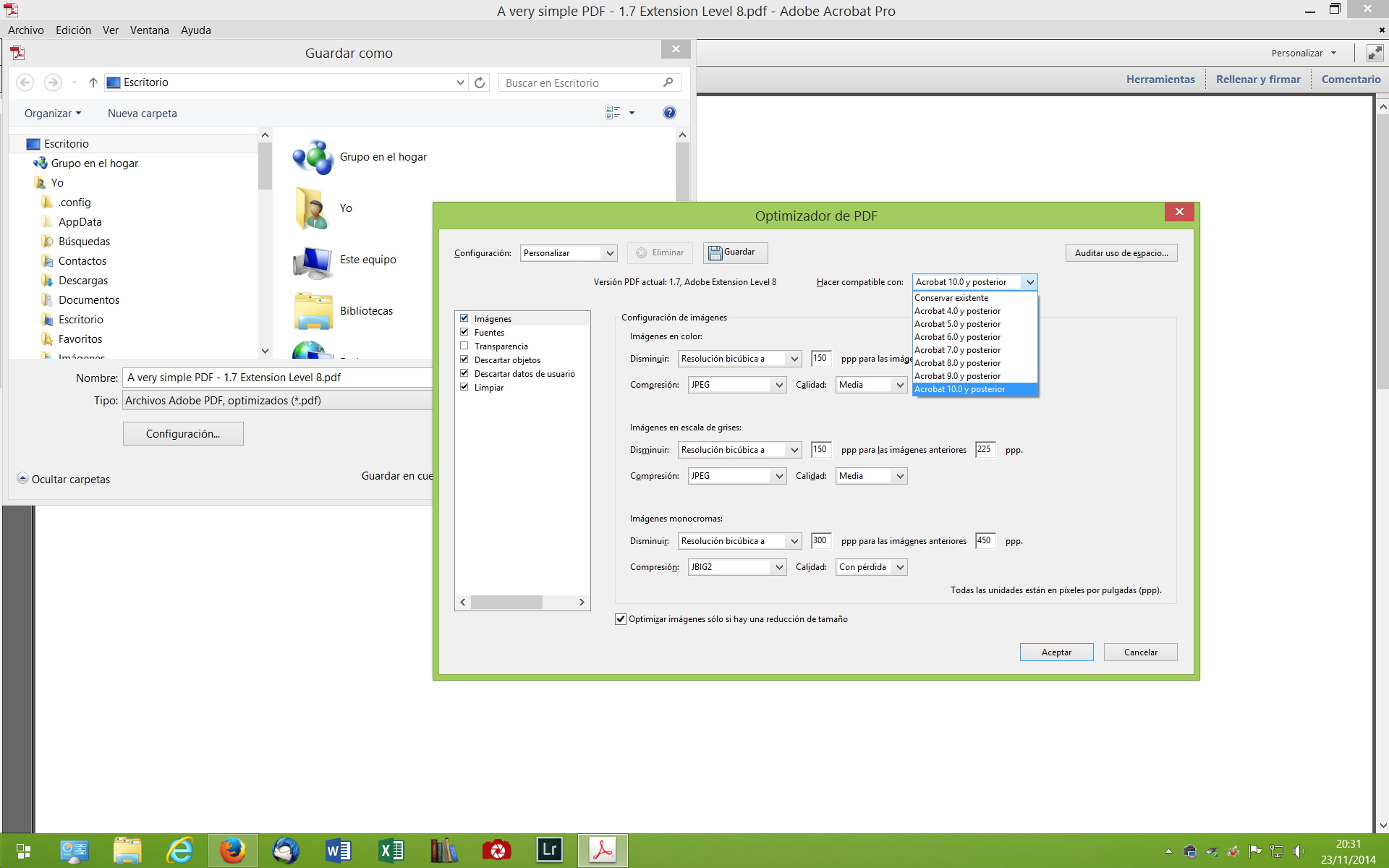

  1. I've started with a very simple pdf file from MS Word. This file is A very simple PDF - 1.6.pdf. 1.6 refers to the pdf version which you can change inside Acrobat. I've gone to Save As>>Optimized pdf file type>>Configuration and then I've changed the very first setting: Compatibility with Acrobat 7.x means pdf version 1.6, 8.x means 1.7, 9.x means 1.7 Extension Layer 3, 10.x means 1.7 Extension Layer 8.
    (I also upload a screenshot: Adobe Acrobat XI - Compatibility setting (save as... optimized pdf).jpg. It's in Spanish but I suppose you can easily follow it. Please forgive me my "approximate" translations into English so maybe it's not actually Save As... optimized pdf but Save As.. Pdf advanced or anything similar).
  2. Then I've saved it with progressive increased versions. I upload the latest possible one: A very simple PDF - 1.7 Extension Level 8.pdf. This file DOESN'T CRASH MY H2O. So I'm not experiencing what DNSB says.

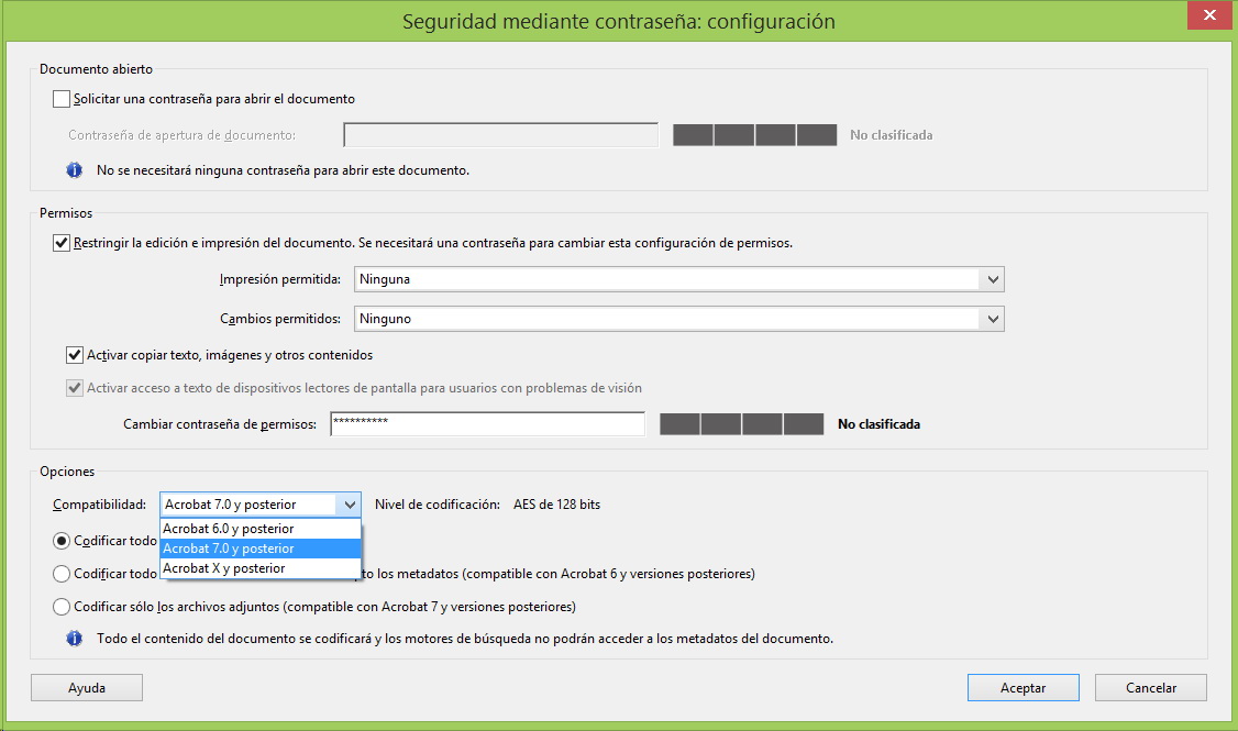

  3. Then I've gone to the file Properties>>Security Tab>>Security system: By password >> Change Configuration.
    A new dialogue appears. I upload a new screenshot with the used settings (Adobe Acrobat XI - Permission setting.jpg). In this new screen you can set the Password length in an independent and additional compatibility drop box. "Adobe 7.x and later" means AES 128 bit and "Adobe X and later" means AES 256 bit.
  4. So I've saved two new files with 128 and 256bit protection (you can imagine their names ). Within these new files ONLY THE 256bit ONE CRASHES MY H2O. The 128bit runs fine.
