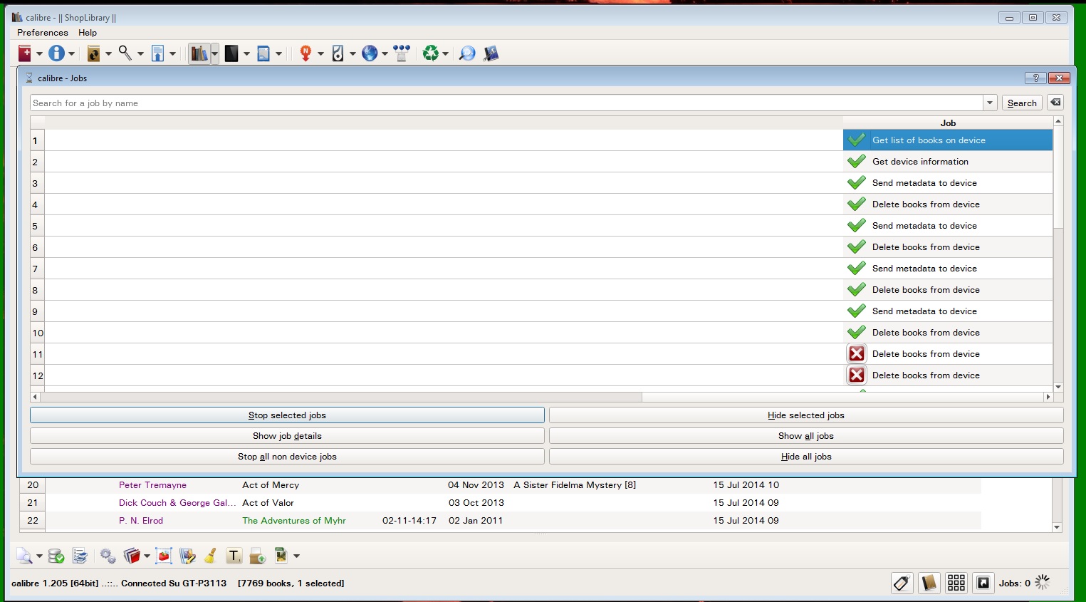

Task manage wierd GUI
I was doing a Android by USB test for reference on W7X64
https://www.mobileread.com/forums/sho...44&postcount=6
I pulled up the Task manager and it was OMG (scroll bar) wide and I could not resize the columnmany of the colum that I could see, were not populated.
Jobs display in 1.205 portable works fine here - but I did NOT have a device connected.

Old 08-10-2014, 07:58 PM   #56
Posts: 32,060
Karma: 65709392
This may be a QT screen geometry quirk (BUG).
I have a second monitor (768x1024) above the WS (1600x900) display on the Laptop
Old 08-10-2014, 08:11 PM   #57
Posts: 32,060
Karma: 65709392
There is something wierd going on.
I disconnected the second monitor. REBOOTED
Started Calibre
Attached my TAB2
Opened the Task Manager
Column heads: Job Status Progress Running_Time JOB
Only Job has info and I can't resize column widths
NB Same cols on 32 bit XP, same lack of resize
BUG
Old 08-10-2014, 08:25 PM   #58
Posts: 22,944
Karma: 34252880
Started Calibre
Attached my TAB2
BUG
@theducks - Try with no device connected - that's my scenario. I just did a folder connect, it was still OK.
Old 08-10-2014, 08:30 PM   #59
Posts: 32,060
Karma: 65709392
W32 had no device/folder connected.
By any chance, are you running from source? I am not.
These are 2 different systems
Old 08-10-2014, 09:05 PM   #60
Posts: 32,060
Karma: 65709392
I just installed 1.48 on the XP machine
Same o
I can only resize the First JOB (to the left of to Status)
I can't do the others and no info in other than Job: Name and Tick when done)
BTW this machine was 204.1 not 205 as is my x64 machine
