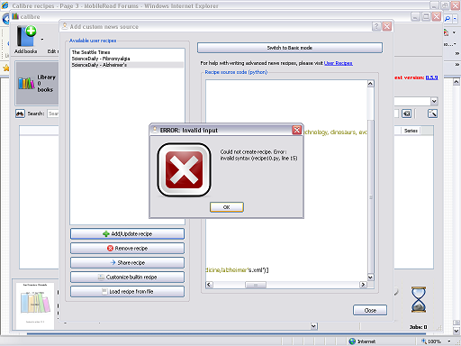

Need help revising recipe please
I'm trying to revise the Fibro recipe to get news on another specific topic but it's kicking back the changes. I think I know what the problem is, but that's the name of the feed unless the issue is elsewhere. It won't even let me save it as a recipe. May I get some help please.
Here is the recipe

The only thing I changed was the title and the feed info. I think the apostrophe in the feed line is creating the issue but don't know enough to be sure. Problem comes in because that is the name of the feed.
Also, please note, in the recipe the part including and after the apostrophe on the feed line is black as opposed to ochre/yellow. Screenshot included. Thanks.
Forgot to mention, I need to add one more feed to the feeds and don't know how to do that. A quick explanation would help.

Your feed url has ' and that breaks the string. Enclose the feed url with double quotes like this:
feeds = [(u"Alzheimer's Research News", u"yourfeedurl")]

Here's what I get now and here's my recipe modified.
Could not create recipe. Error: invalid syntax (recipe 20 py, line 15). This changes everytime I make a change but the line number stays the same.

I know nothing about this type of programming so I am accomplishing the separation above using carriage returns - which I'm sure is wrong. Tried using a "tab" but that didn't work either. I'm feeling really dumb right now since I took visual basic programming a while back and should be better at this even tho' it's different. Sorry, and thanks for your help.
