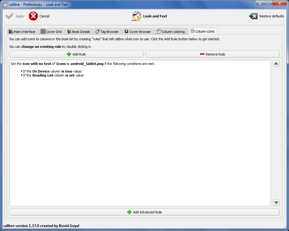

The second capture shows the icon rule I used, putting your Android image on the Icon columns. I left off the OnDevice because I didn't want to be required to connect.

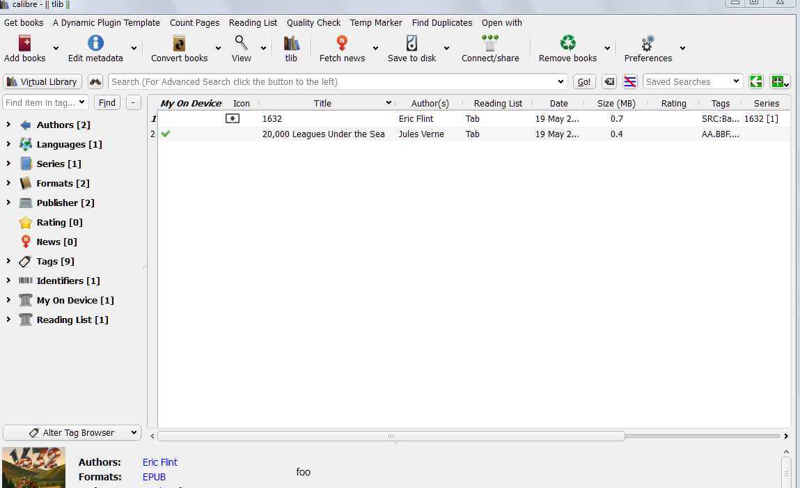

The third capture shows the resulting library, showing the icon.

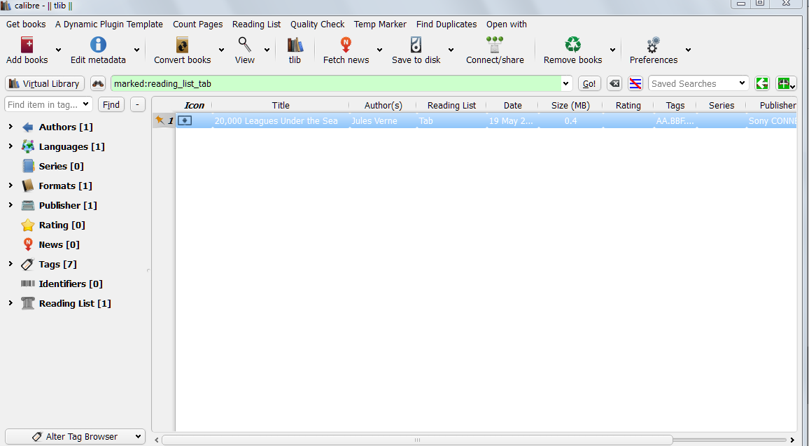

The fourth capture shows the library after asking Reading List to show the Tab list.
ID:	123148   Click image for larger version
ID:	123149   Click image for larger version
ID:	123150   Click image for larger version
