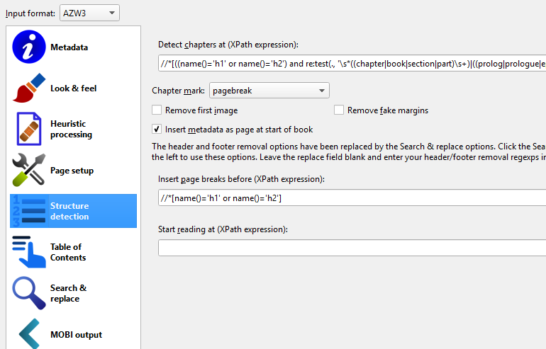

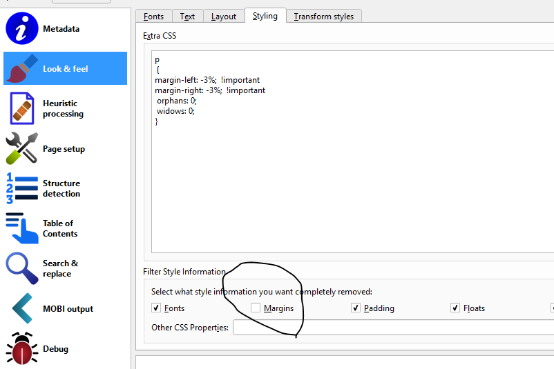

I think I got it!!! You have to mark off "look and feel->Margins" and "structure detection->Remove fake margins" !!
Thank you very much, kovidgoyal !!!
ID:	167688   Click image for larger version
I hope that is so. What in hell is a fake margin? The settings you illustrated do not really make sense to me. But if the hack works...

Device: Paperwhite 4; Galaxy Tab
There must be something more here. The code you have in the "Extra CSS" is illegal and should have been ignored. (look at the placement of semi-colons) I tried it and it failed--just as my legal code before did. Well, if it works for you, that is good, right?
