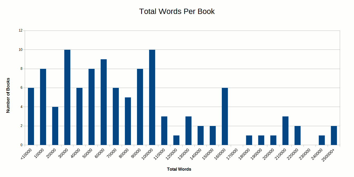

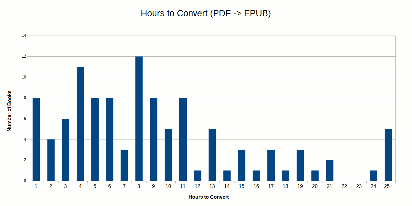

You should try to keep track of hours, it is quite interesting seeing how much faster/better you get at creating the ebooks.
As I mentioned, it used to take me two weeks of work to go from PDF -> finished EPUB, now I pump out the typical non-fiction economics book in ~8-15 hours.
Side Note: I have a bunch of stats I have been gathering, maybe when I get some more free time I will create a topic on MobileRead showing off the "research". Haven't touched the spreadsheets since March (and still have a ton more info to add to it).
Here is a preview of the Hours to convert + word count of books since I started keeping in-depth track of my hours (~October 2012):
ID:	122328 Click image for larger version

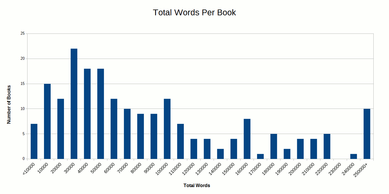

and here is the word count of all books I have converted to EPUB:

Glad to hear I have inspired someone else to start keeping stats. I love keeping stats on things that I do. You can get cool things like this:
I liberated 18,172,166 words from PDF -> EPUB since October 2012. (Although I haven't updated the stats in about a month).
And EPUBs that I read for pleasure + cleaned as I went along, 2,870,128 words.
I will have to go through and add in a Page Count to all of the books as well... that might also lead to some decent stats/graphs. (Although in my opinion, pages are a horrible way to measure. A page of non-fiction =/= a page of fiction =/= a page out of a journal/newspaper =/= a page in different font/font-size/margins). And how would you go about handling measuring "Pages" of text from an HTML source?

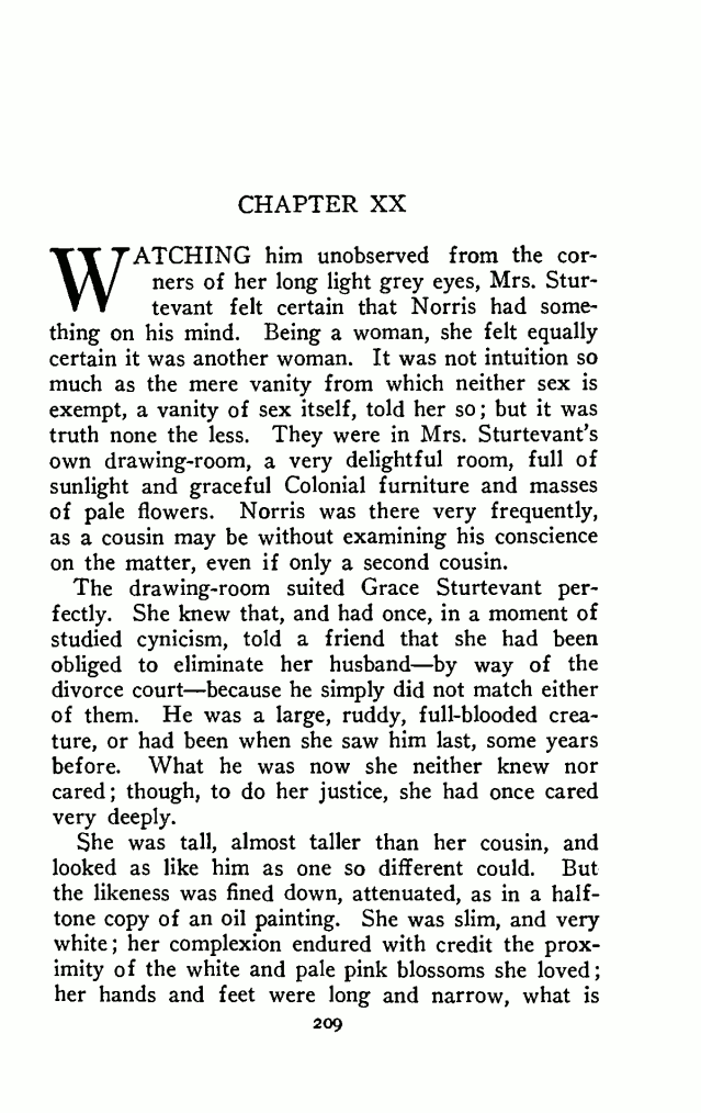

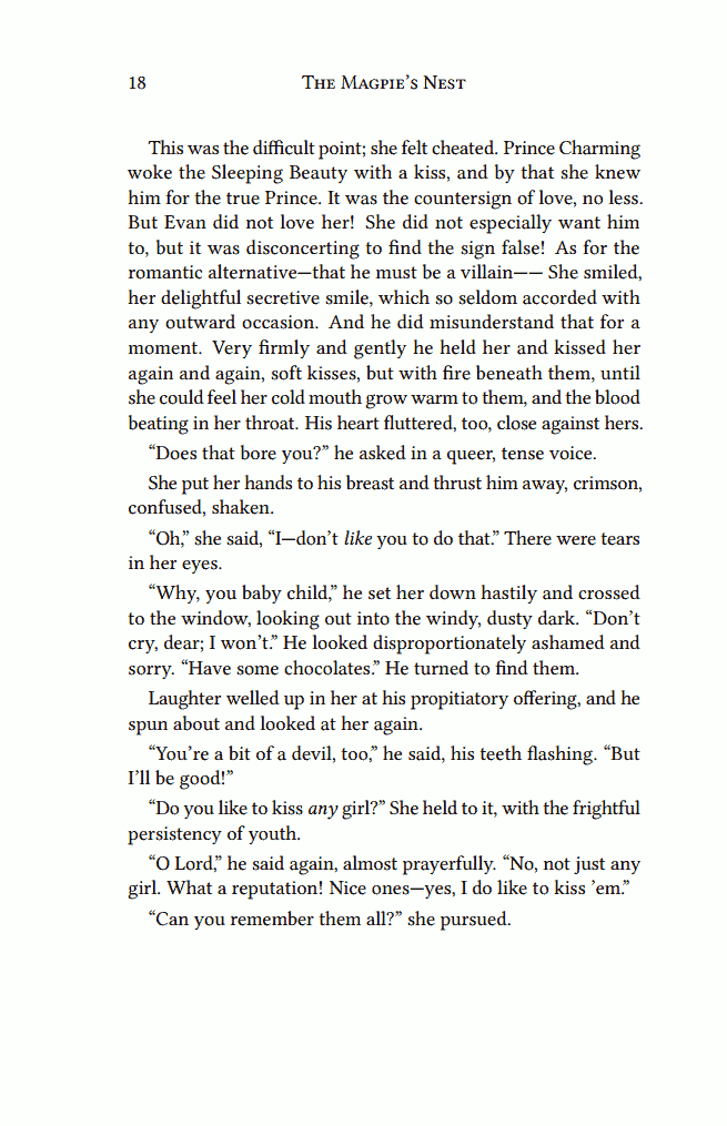

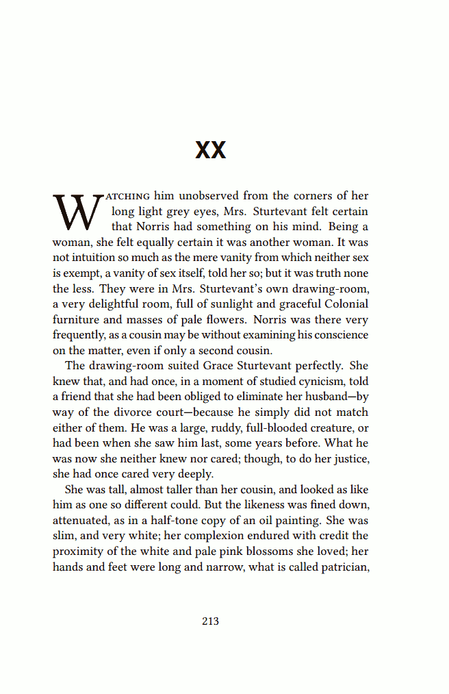

And speaking of trying to "match page size/layout"... Here is a sample of some of my latest ventures into working backwards from EPUB -> LaTeX -> PDF:
ID:	122624Click image for larger version
ID:	122626Click image for larger version
ID:	122628Click image for larger version
ID:	122630Click image for larger version
I still have to iron out a few kinks... but I have the basics of the workflow going... now I just have a lot more to learn/absorb/code.

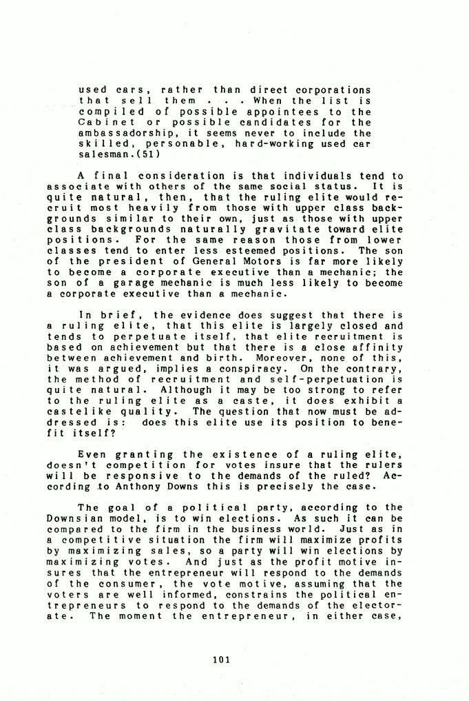

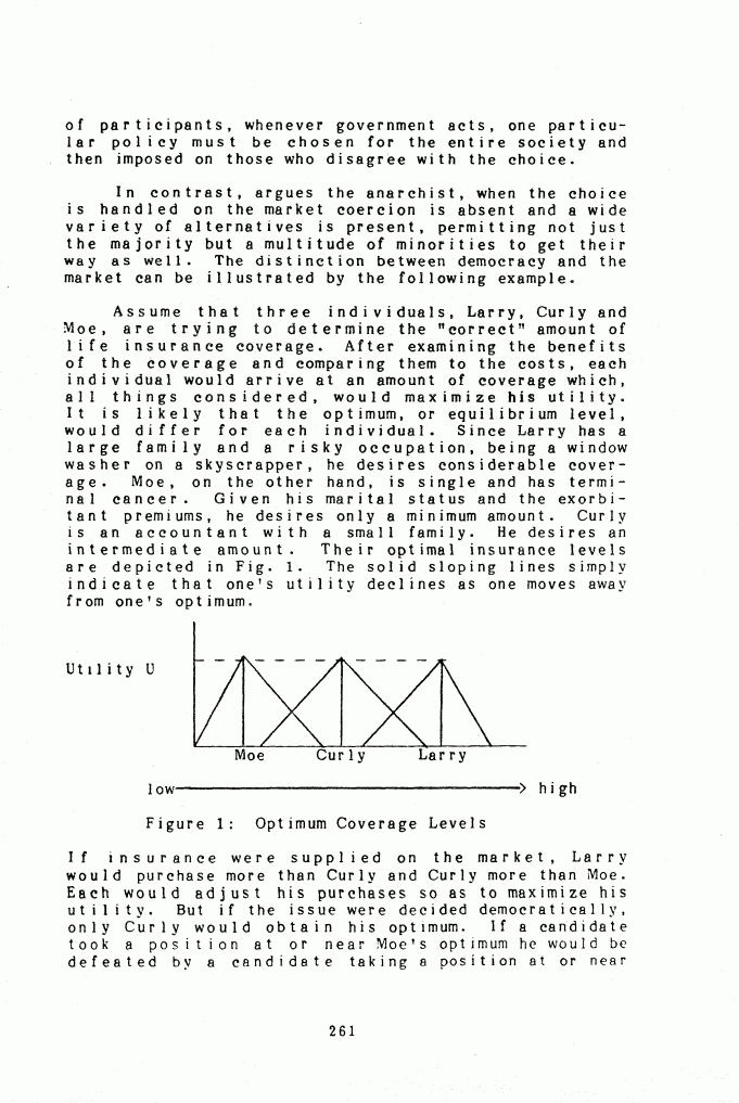

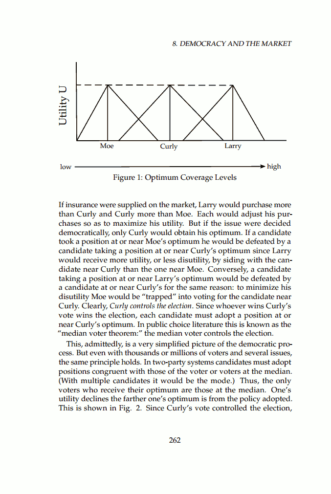

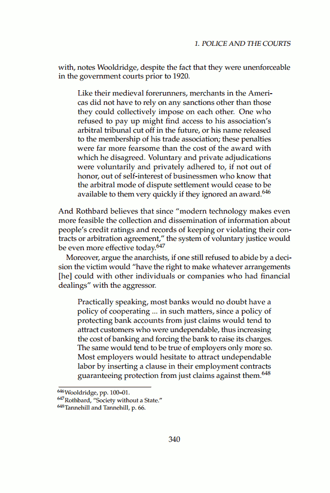

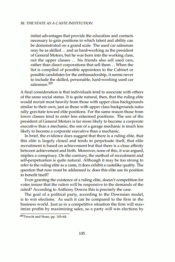

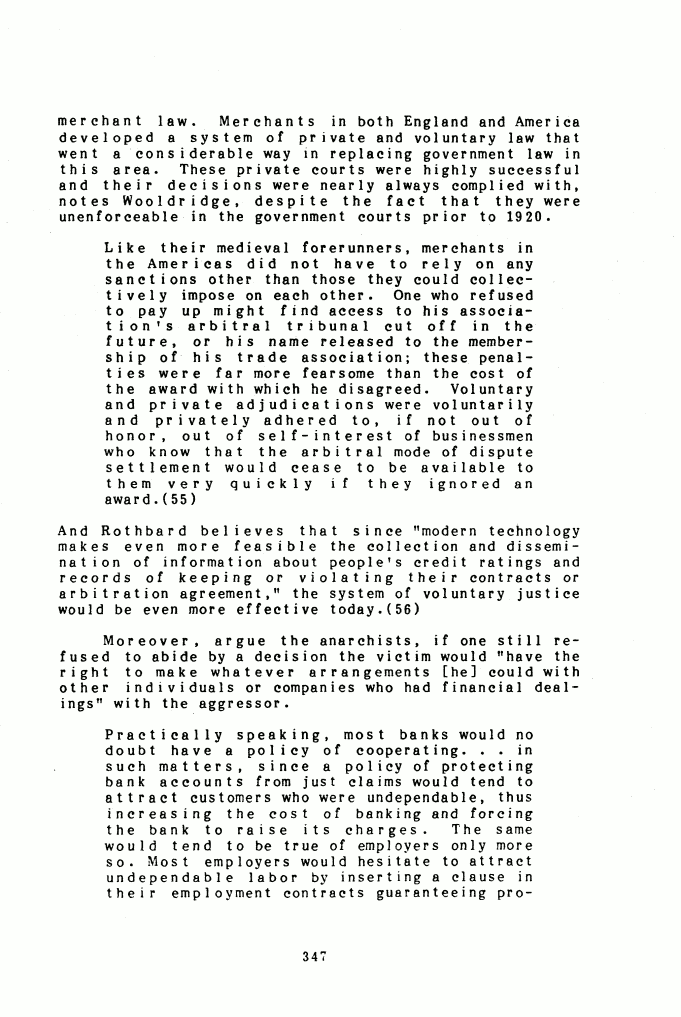

Thank you, I have been fishing around those PDFs/sample images the past few weeks, and it DEFINITELY blows the pants off of many of the scans that are currently out there. The few companies I do EPUB work for were definitely impressed with the quality of the PDFs.... (But as I said, I still have A TON to learn).
This method of PDF creation might be very nice in the cases where the condition of the original/older scans wasn't the greatest, (there might be writing/markings in the book, yellowed pages, water stains, ink blots, margins cut off, etc. etc.) (Take a gander at many of the Archive.org PDFs).
And these PDFs will DEMOLISH the current reprinted junk that is out there (scan -> slap on front/backmatter -> reprint, or scan -> very minor speckle cleanup -> slap on front/backmatter -> reprint).
Also, for those who DO want to read the PDF over an EPUB (I don't know who would be crazy enough to do this. ), then this LaTeX generated PDF will destroy the crappy PDF scans.
For example, here is some comparison shots of the first PDF I tackled using this method:
ID:	122635Click image for larger version
ID:	122637Click image for larger version
ID:	122639Click image for larger version
(and let me tell you, try not to start off with SUPER HARD books the first time. I keep on falling into these traps, I did the same exact thing when I first started making EPUBs. Tackling the hardest books under the sun first! ).
