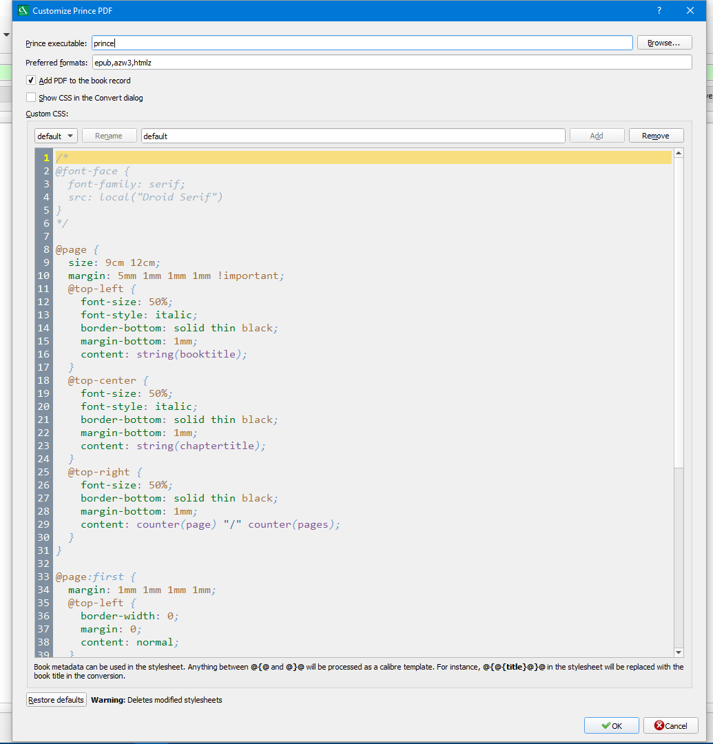

I'm having the following problem: the bottom of the configure dialog is cut off, as can be seen in the attached image.
calibre 2.58 [64bit] on Windows 10 Pro
Name:	Prince PDF configure dialog.png

@readin:
Most Calibre customization dialogs are resizable to some degree via the mouse. Drag a top corner down, reposition it, then resize and reposition repeatedly as needed.
You can then use the scroll-bar to see what is otherwise not visible.
DaltonST

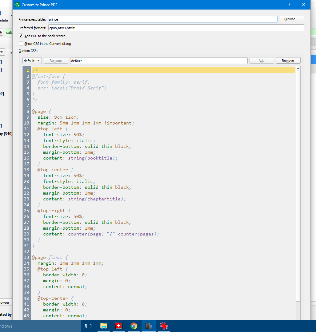

The first attached screenshot shows what the dialog looks like after I try to drag the top border down -- it won't drag down more than a tiny amount.
If I attempt to move the dialog around, I can sometimes get the dialog to look like in the second screenshot, with part but not all of the bottom panel showing.
Also, as can be seen in the second screenshot, the scrollbar is only for the CSS stylesheet in the middle panel, and doesn't scroll to the bottom of the dialog.
Name:	Prince PDF configure dialog after dragging top border down.png
ID:	149408   Click image for larger version
Name:	Prince PDF configure dialog after moving window.png

I don't think I have added anything that should affect this, and I can shrink the dialog until the CSS stylesheet is only 2 lines high.
The size is adjusted (when the dialog is created) with the adjustSize() method, maybe the window manager is affecting how this works. In other words, I have no idea what's the problem or how to fix it.

In case it helps, I discovered that changing my Windows settings to auto-hide the Taskbar allows the entire dialog to show, as in the attached screenshot.
Name:	Prince PDF after hiding Taskbar.png

@readin:
I too have Windows 10, so I installed Prince PDF. Same issue as you. However, it was simply fixed by right-clicking the Windows Taskbar then clicking "Show Windows Stacked". To seal the deal, I clicked "OK" in the customization dialog, which causes its current dialog geometry to be saved. I entered config again, and it was just like it was when I last clicked "OK".
Don't try this at home, but in the past while actively developing an oversized dialog, I had to do it this way:
Edit file "C:\Users\???\AppData\Roaming\calibre\gui.json " after making a safe backup copy (if you corrupt that file, Calibre will crash with no notice and no stated reason)
and delete:
  "plugin config dialog:User Interface Action:Prince PDF": {
    "__class__": "bytearray",
    "__value__": "AdnQywACAAAAAAA0AAAANAAABmEAAAL7AAAAPAAAAFMAAAZZAAAC8wAAAAAAAAAAB4A="
then save.
That bit above is your saved window geometry for that dialog. Deleting it resets it to nothing, causing the "factory defaults" to kick in. You can then resize the dialog before clicking "OK" to save.
You should do it the easy way as I indicated in the first paragraph.

What happens if you snap the window to maximum height? This solves a similar problem I have in Windows 10 with dialogues in a video editor.
Thanks for installing the plugin to try it out.
I was able to view the entire dialog by stacking the windows as you suggested, but clicking OK didn't save the dialog size for me -- next time I opened it, it was too big again.
If I just move the window around, sometimes it will show part of the bottom panel, as in the second screenshot here. When I drag the window up to the top of the screen, it appears to snap, but it actually makes the stylesheet panel longer, so that I can not see any of the bottom panel.
I also tried pressing <Windows logo key> + <Shift> + <Up Arrow>, which normally stretches a window to the top and bottom of the screen, but that has the same effect as dragging the window to the top of the screen. I also checked the system menu (upper left corner), but the dialog can't be maximized.
In any case, by hiding my Taskbar I was able to configure the plugin, but now I have a new problem:
